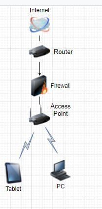

                @johnpoz look at the diagram, on the router the printer is configured with static ip this is the 192.168.x.x network
                the firewall has another network 192.168.1.1.
                now I want the printer configured on the router to work on the firewall
                • ? Offline
                  A Former User @johnpoz
                  @johnpoz the printer is connected on the wan side

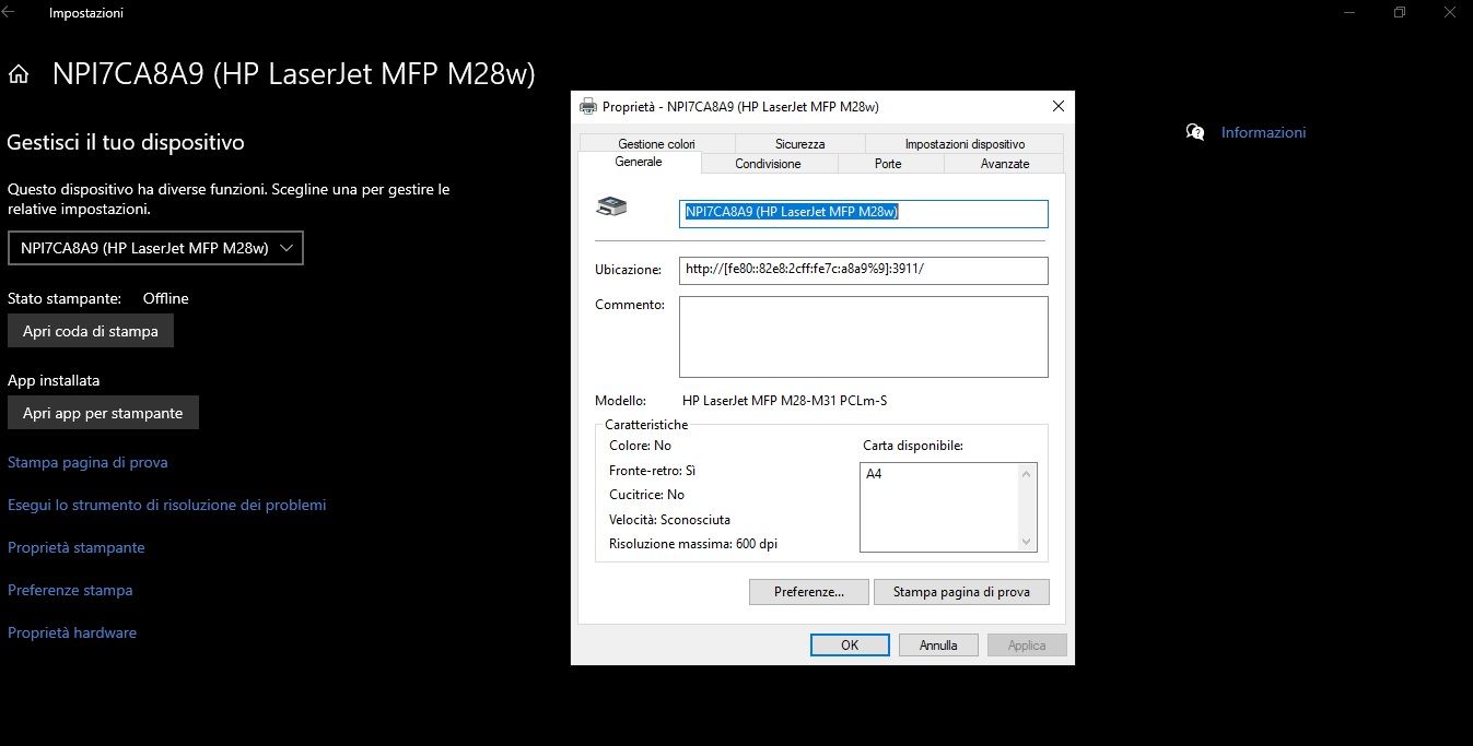

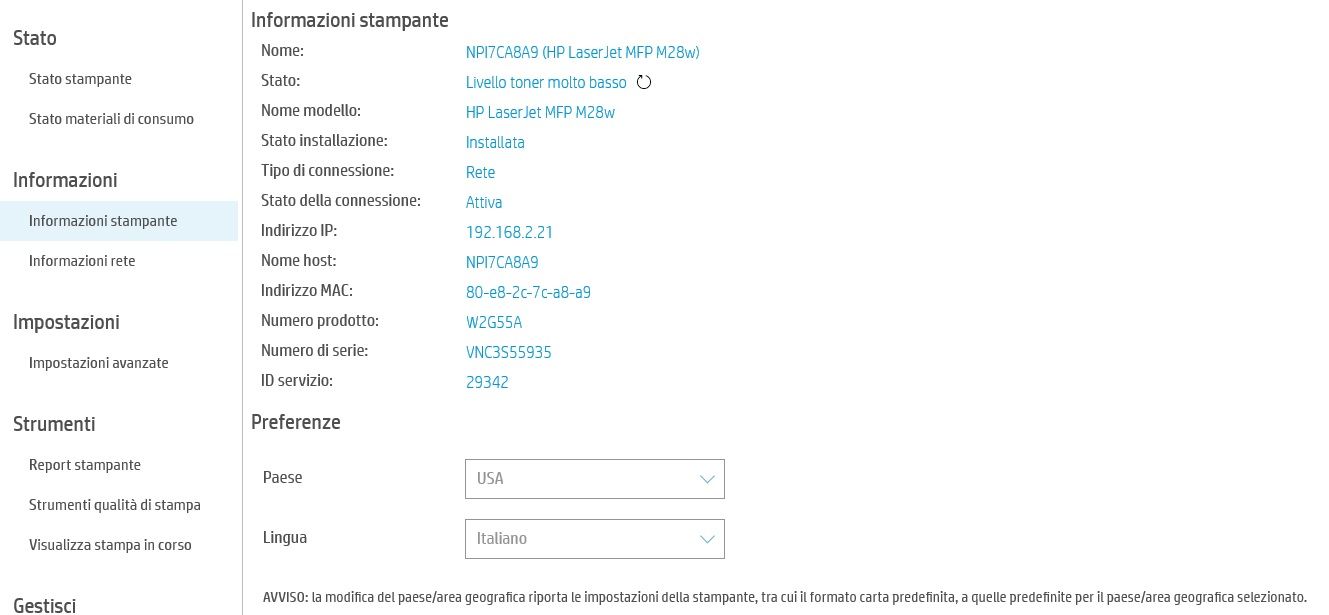

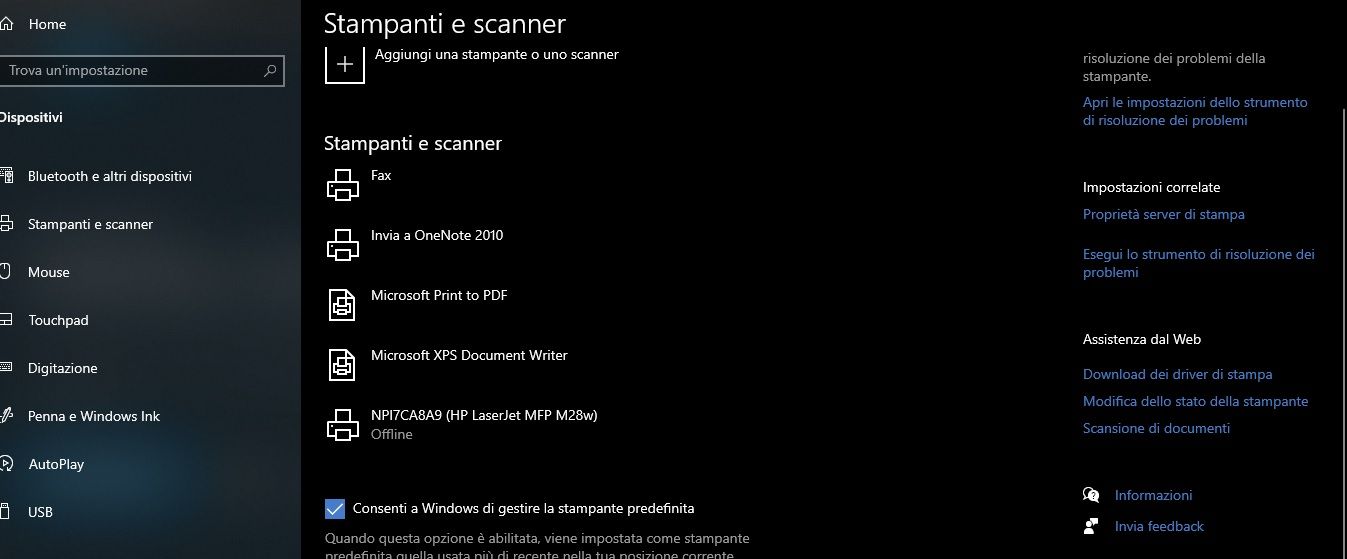

                              @stephenw10 Hi, the printer is on the fritzbox network 192.168.2.1 the error it gives me is: printer offline. I cannot print from the 192.168.1.1 network, also the printer has a fixed ip. The printer is an HP LaserJet Pro MFP M28w Printer.

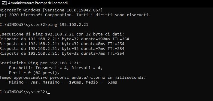

                                        SteveITS Rebel Alliance @Guest
                                        Can you ping the printer's IP from the PC?
                                        Upvote 👍 helpful posts!
                                        • ? Offline
                                          A Former User @SteveITS

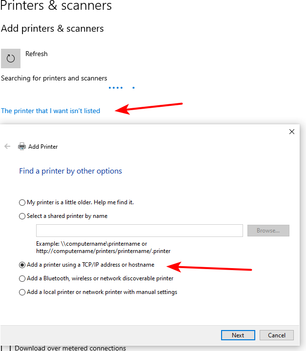

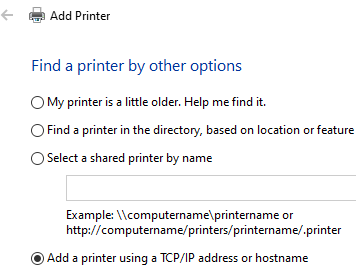

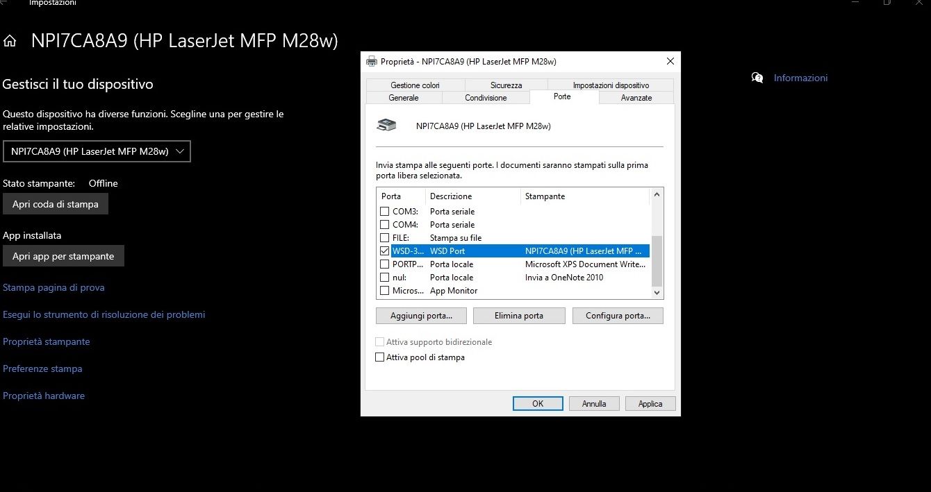

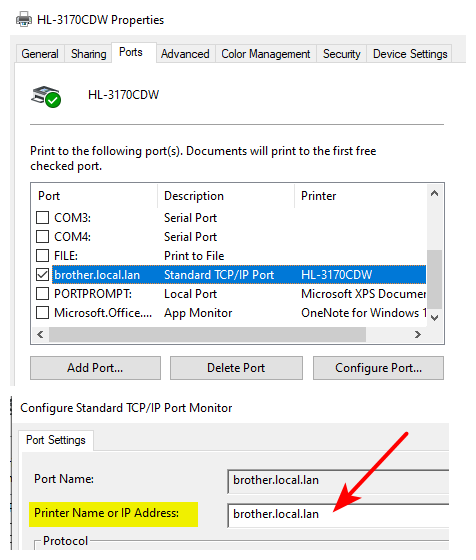

                                            Right, so you should be able to print to 192.168.2.21 too.
                                            You cannot just 'find' it on the network in Windows because it's no longer in the same subnet. You must setup the printer on that IP in Windows.
