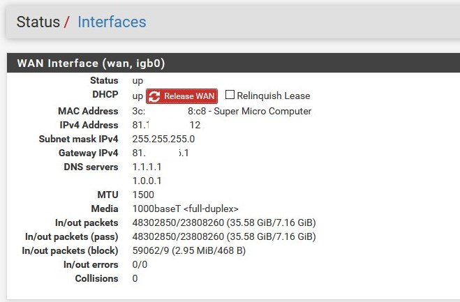

      For some reason occasionally ( about once a month) the internet connection goes down and the PF sense displays 'Down' within the DHCP gateway interface . It is simply fixed by checking 'relinquish lease' checkbox and release wangateway'. I am assuming that there is a problem between the Modem DHCP (Hitron Modem ) and the PF sense getting the IP address. This maybe due to my dynamic IP from the ISP and is likely happening because the IP address of the ISP is changing .

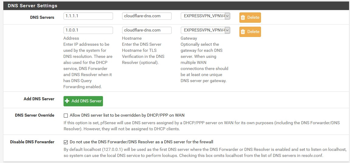

        I think this could be a DNS issue IIRC . THe PF sense is set to get the DNS address from the Upstream ISP modem . I think it gets a DHCP address , though potentially is not getting a DNS address .
        Should I just add some public DNS addresses to the WAN interface (8.8.8.8, 8.8.4.4) ?

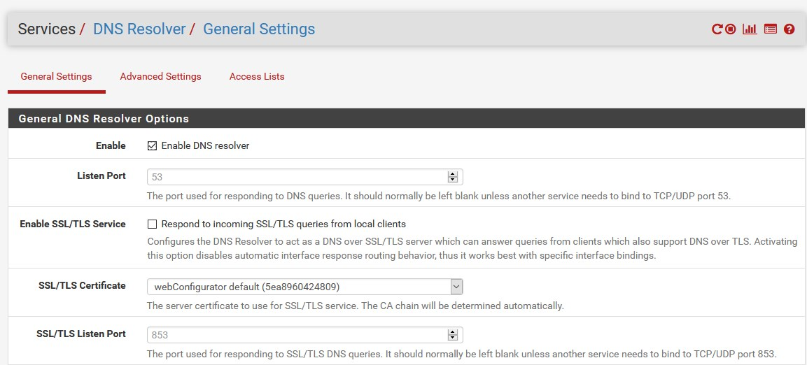

          @90Ninety "Should I just add some public DNS addresses to the WAN interface (8.8.8.8, 8.8.4.4) ?"
          What do you use as DNS on pfSense?
          Here are some setup examples... ๐Ÿ˜‰
          ++++ Unbound (resolver)

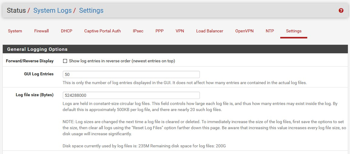

                The GUI isnt currently displaying entries that far back . I think it had been set to 50 lines( by default)

                  Increase log size if you have a lot of entries and can change the displayed rows on the GUI as well

                    The maximum log entries shown by GUI is 2000 , and that brings up more entries but still only from the last few days

                          Or if you have the right size storage, increase the log area:
