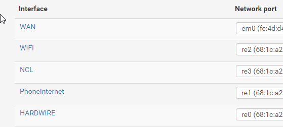

                What network cards are in it?
                I am not sure if there is a way to identify the cards through pfsense, I have never tried. I am sort of guessing at the integrated..
                There are 3 network cards in it, the integrated, and 2 third party cards
                The two third party cards are these
                Rosewill RNG-407-Dualv2
                https://www.newegg.com/rosewill-rng-407-dualv2/p/N82E16833166096
                The integrated is:
                Realtek RTL8111GN - I believe if i pulled the right spec sheet I will need to confirm this though.
                The third party nics are not totally in use, only one is used and with a single port to run the lan and wifi.
                I had a much more complicated setup to dedicate a network to my wife's work computer but have since torn this down for the sake of simplicity.
                The integrated nic has the wan attached to it.
                The computer is either an m90p m92p or e73 thinkcentre, my money is on it being an m92p.
                I should add, this has been the issue since day one of using this computer as a pfsense router. It has been like 2 years of this :(
                • SteveITSS Offline
                  SteveITS Rebel Alliance @RigidConduit
                  The Interfaces/Assignments page will show the interface names, which is based off the driver being used (re0 etc.). I have seen many people complain in this forum about Realtek drivers in FreeBSD, though in the one non-Netgate hardware device I've managed it's not been a problem. Since the WAN interface is using Realtek then you could try moving WAN to the unused interface and see if the problem continues.
                  Upvote ๐Ÿ‘ helpful posts!
                    RigidConduit @SteveITS
                    @steveits
                    If that is the case, what is em ? o.0
                    I must be wrong about the spec sheet I pulled then which I guess is a little expected, I use 3 different computers at work and they all look almost completely identical, but hardware is different, I must of got the model wrong. This particular machine is just a spare machine off the floor that I grabbed.
                    It looks like the 4 nics provided by the third party cards are realtek then.
                    I am not sure the effects of these having issues but IF its only the card having trouble and nothing else, it will explain why I lose the lan as well then.
                    In which case if I swap the two cables I (in thoery?) lose the internet but not the lan.
                    In the case of the picture, the 'WIFI' interface is the LAN just relabeled
                    • SteveITSS Offline
                      @rigidconduit said in Issue with pfsense taking a nose dive until reboot:
                      what is em
                      Intel so that's very likely not the problem.
