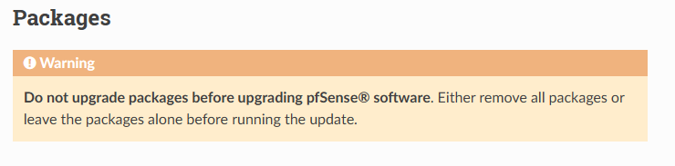

                        You prob borked something up running package upgrades when not on current version.
                        https://docs.netgate.com/pfsense/en/latest/install/upgrade-guide-prepare.html#packages
                        If it was me - I would do a clean install. To get yourself on current.. And to make sure you don't have any sort of issues related to wrong versions of packages installed for the version your running, etc.
