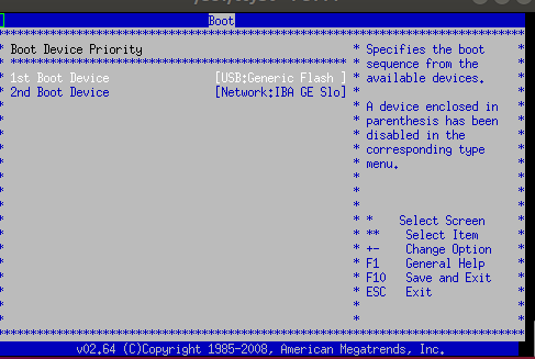

@mnobrega You may have to check its BIOS to see if the boot order is correct to boot from USB, if it even supports that.
@kom in the bios I put the boot to the pendrive. if I put an old version of pfsense it boots correctly but doesn't go past the splash screen. gets stuck with cant find boot entropy message

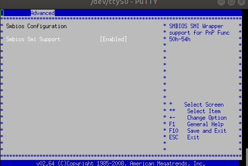

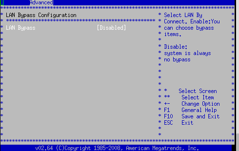

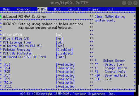

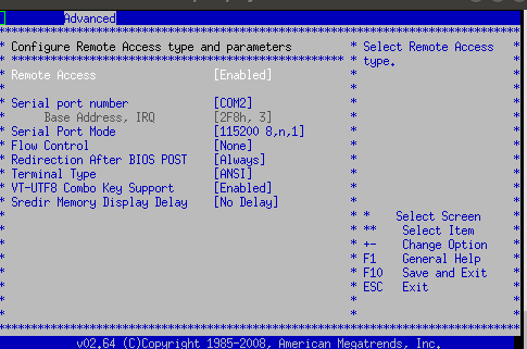

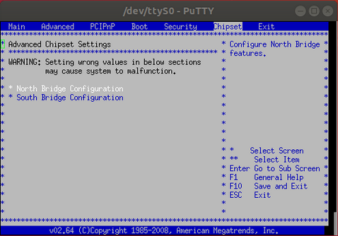

@kom Can I post the prints I have of the bios screens here on the forum?
@mnobrega If you like.

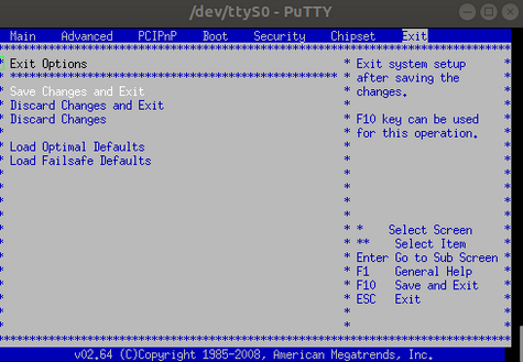

@kom this is the bios screen of the apliance I have here. I put the screens to see if you guys help me configure for pfsense installation
@mnobrega First thing I would try is failsafe defaults, followed by optimal defaults.
Can we see the boot log showing exactly where it stops responding?
I assume you're connecting with Putty at 115200bps?
@mnobrega Is there any option in the BIOS to change the boot option to BIOS as opposed to UEFI only? and or change to legacy??
‘Legacy Boot Enable, Secure Boot Disable’.
