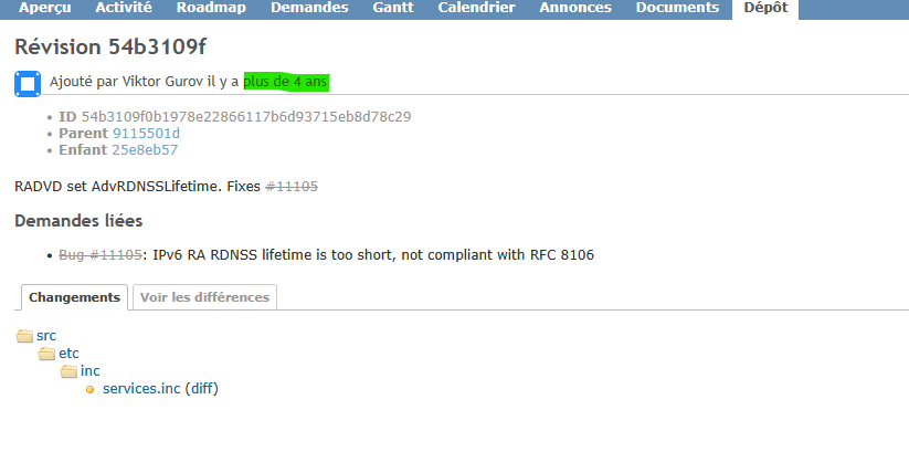

              I'm still new to pfSense and feeling my way around but it looks like this contradiction was introduced into pfSense here:
              Bug #11105
              It was closed on Redmine but without resolving the warning issue or moving it to a new bug report.
              With your thoughts on the difficulty on changing the fault mask, fixing the actual issue may be the easiest path?

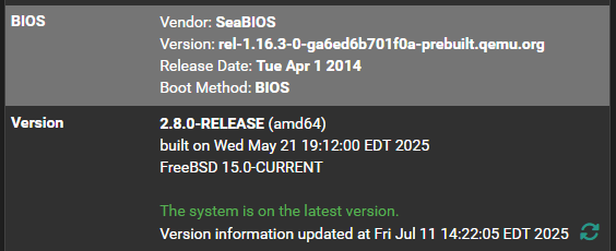

                                  • JonathanLeeJ Offline
                                    JonathanLee @RobbieTT
                                    @RobbieTT can I apply this patch in 23.05.01 ?https://redmine.pfsense.org/projects/pfsense/repository/2/revisions/54b3109f0b1978e22866117b6d93715eb8d78c29
                                    Make sure to upvote
                                    GertjanG RobbieTTR 2 Replies Last reply Reply Quote 0
                                    • JonathanLeeJ JonathanLee referenced this topic on
                                      Gertjan @JonathanLee
                                      @JonathanLee said in Do the default RA's need tweaking.:
                                      taht patch was applied more then 4 years !?
                                      • RobbieTTR Offline
                                        RobbieTT @JonathanLee
                                        Presumably not but there will be some RA tweaks in 25.07, which is not that far away from release.
                                        bearhntrB 1 Reply Last reply Reply Quote 1
                                        • bearhntrB Offline
                                          bearhntr @RobbieTT
                                          @RobbieTT
                                          What about in this version?
                                          RobbieTTR 1 Reply Last reply Reply Quote 0
                                          • RobbieTTR Offline
                                            RobbieTT @bearhntr
                                            @bearhntr
                                            I would presume not, at least not yet.
