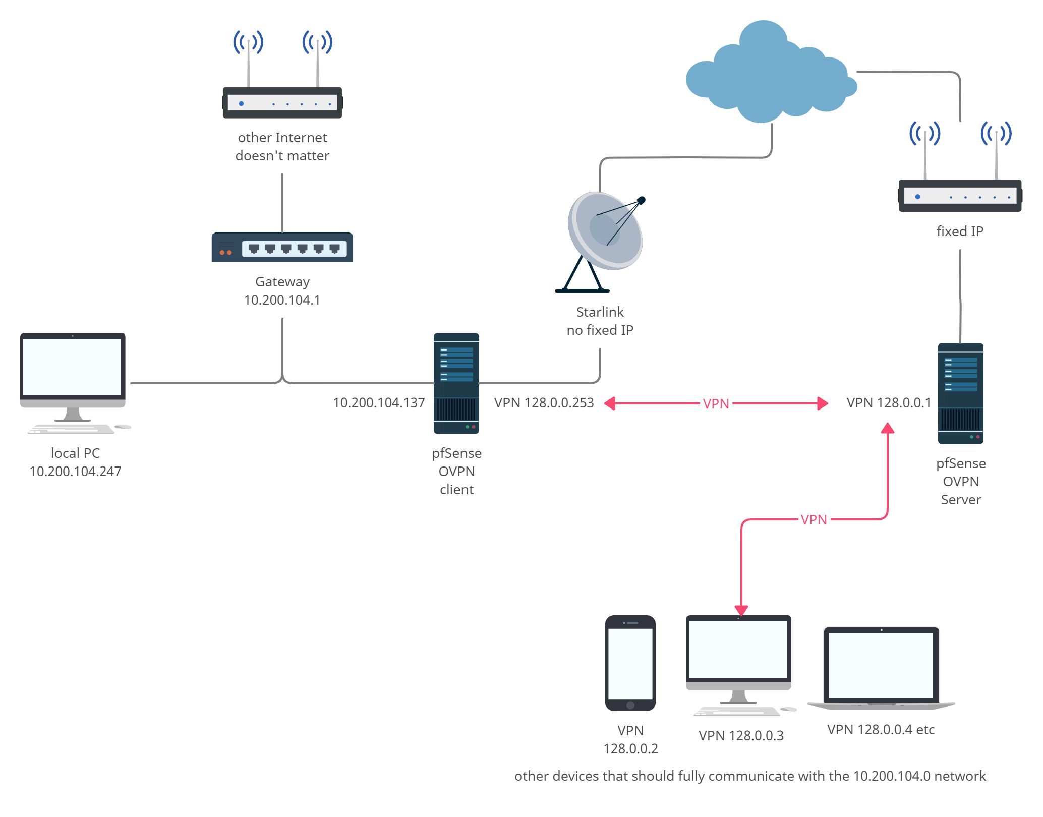

maybe this picture makes it clearer what i need:
Definitely.
The public tunnel network doesn't matter for routing between the two locations, but the connected clients won't be able to access this real network range in the internet.
BUT all the devices, that connect to the VPN Server should fully communicate with the local 10.200.104.0 network so the pfSense(client) must act like an acces server and the pfSense(server) must route every package to the pfSense(client)
Might be easier to set up an additional site-to-site server to connect your location than fighting with CSO, but it will also doable with an access server for sure.

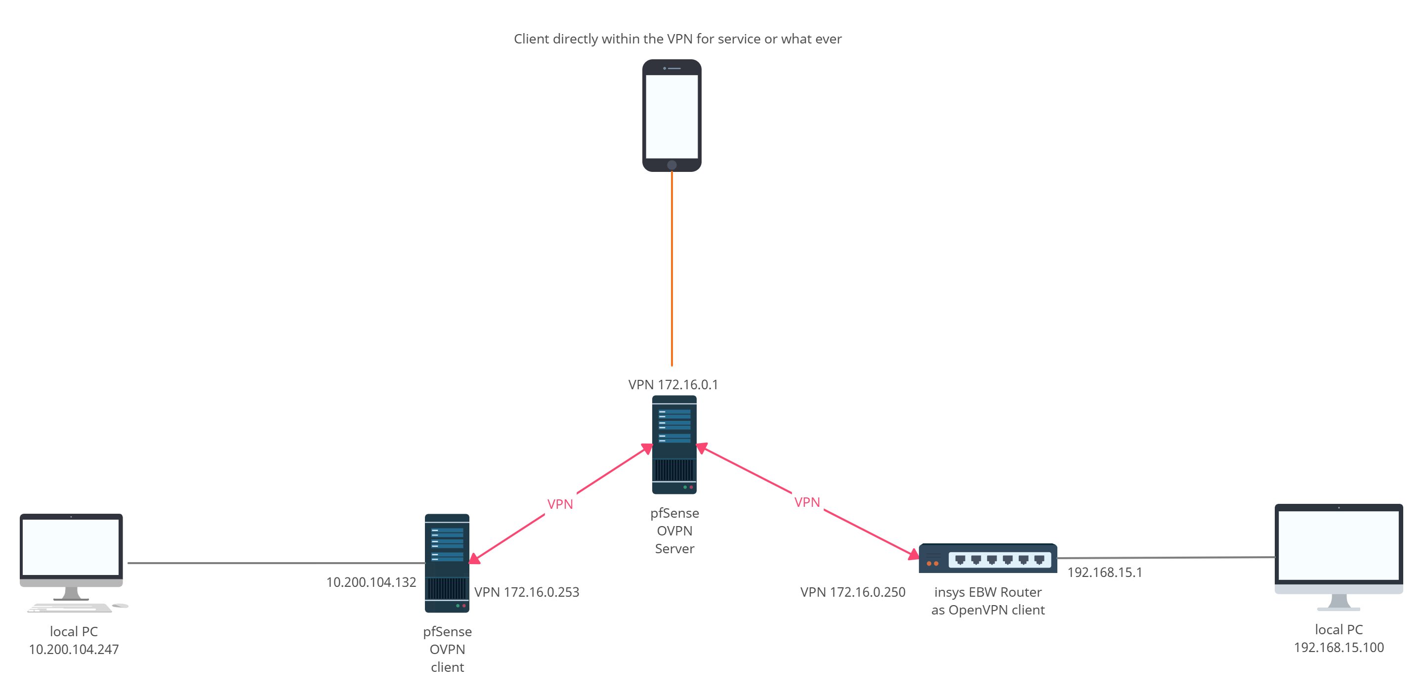

i made a new picture:
This is the current configuration as it is currently set up. i have my main network (10.200.104.0) and a remote network (192.168.15.0) later i will add many more remote networks that should all communicate with the main network but not with each other. These do not exist yet, but will be added in the future.
The smartphone should also be part of the VPN for service purposes, to get to the web interfaces in case of emergency (not mandatory but nice) could be an Android phone with OpenVPN connect app.
You can see in this picture, that i set the local pfSense as Standard gateway to sort out sources of error. And i changed the IP-Range of the VPN as mentioned above.
@knausepeter
With regard to your obvious troubles with CSO I want to repeat my suggestion from an upper post to put that VPN connection behind which you want to access servicse on a separate server.
Otherwise apart from CSO you need to enable communication between all VPN clients connected to the server, which might not be desired. It is not possible this way to control the traffic between the clients with firewall rules on pfSense, cause it doesn't pass the filter part.What are your concerns on running multiple OpenVPN servers?
