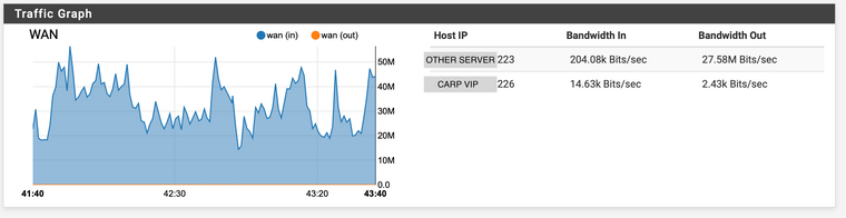

The traffic you will see below is the traffic that I don't want to process :)Anyway, I would add that, in PFSENSE GUI->Status Graph-> WAN (local), I can see:
- the traffic generated by CARP IP (is very low because behind the pfsense instance there are no hosts at this moment)
- tthee traffice generated by a different server on the same network (please see the attached image).

And more importantly they are all using multicast destination addresses so they are correctly ending up at your WAN locally. That traffic is just dropped until you have the NIC in promiscuous mode. Those logs are expected on an HA pair but you can still drop and not the traffic with a rule.
It's all UPnP and mDNS.https://en.wikipedia.org/wiki/Multicast_address
