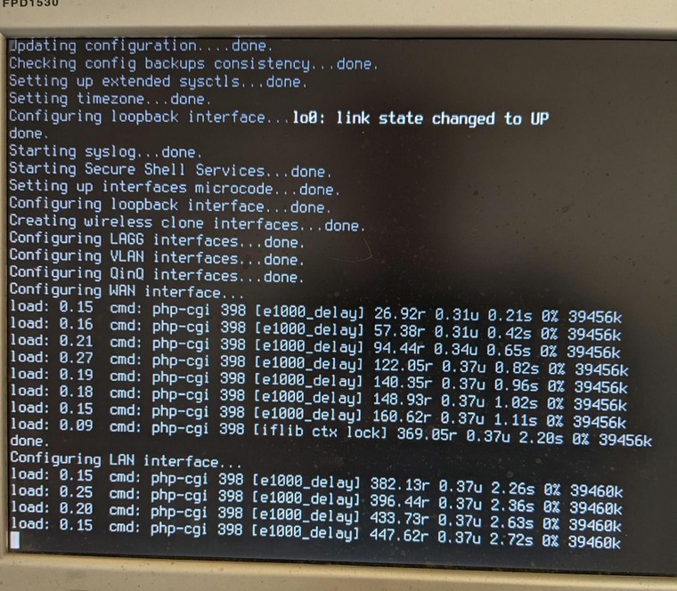

                  Try this. Reboot at the console and when it gets to the 10min wait try pressing ctl+t.
                  That should show you exactly what process it's waiting for.
                    justsomeguy6575 @stephenw10
                    ok so here is where it seems to be hanging up at.....
                    • stephenw10S Online
                      Huh. I assume you are not using the pccard reader for IPSec auth?
                      We actually just patched that to prevent it starting unless you need it.
                      Try applying it via system patches using the commit ID shown here:
                      https://redmine.pfsense.org/issues/11933#note-7
                        Seems like progress but now delaying in a different spot...
