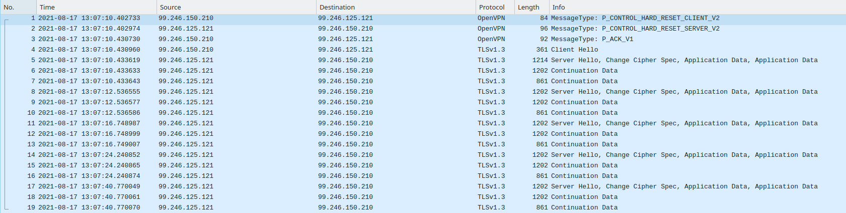

                                    As I mentioned, I used to be able to connect, but that failed with 2.6.0, IIRC. Ping works, but OpenVPN doesn't. However, it does if I tether to my cell phone.
                                    Here's what I get when I try to connect via my 2nd connection. Similar would happen with ssh.
                                    packetcapture.cap
                                    UniFi AC-Lite access point
                                      Hmm, that's between your two WANs somehow? I could definitely see that failing...
                                      • JKnottJ Offline
                                        JKnott @stephenw10
                                        The thing is, it used to work, prior to 2.6.0. Those are 2 completely independent subnets. After I updated to 2.6.0, I wasted a lot of time trying to understand what was wrong with my configuration, until I realized I had done nothing wrong. It was pfsense or perhaps FreeBSD that failed.
                                          Between 2 pfSense devices then?
                                          Hard to see how that could have worked between two interfaces on the same device...
                                          • JKnottJ Offline
                                            JKnott @stephenw10
                                            Between pfsense and a notebook computer. I have a ThinkPad which I use for testing. It runs Linux and prior to pfsense I was also using Linux for a firewall. It worked then and after I moved to pfsense about 5.5 years ago, it continued to work. Then 2.6.0...
