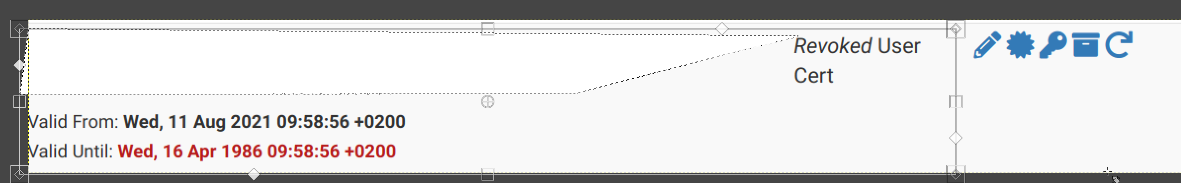

@jimp Thank you for your reply, but on this certificate on the GUI I don't see the icon for deletion next the others. On other certificates I can see that icon but on this one no.
Are there other ways to delete it?
Thanks, BR -

I believe someting wrong has appened in previous upgrade, then I've tried to reissue the cert, but the valid until date didn't change correctly, so I've revoked the cert and this is what is shown now:

Re-read my last reply above. It's probably not letting you delete it because it's used by a CRL. Get the cert serial, remove it from the CRL, then remove it from the GUI, and revoke it by using the cert serial.
@jimp thank you, I've reloaded the manually edited xml, now the errors are gone!
