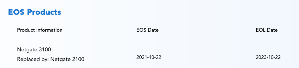

        I did a factory reset and same issue persists. Appears to definitely be hardware related. Am I out of luck with getting this replaced since I am now seeing that the SG-3100 is EOS and Amazon states they are currently unavailable? I'd send this back to Amazon and get refunded, but it appears the next model that would support a gig Internet connection is the 5100, which is more than what I need and is out of my price range.

            @blewwrx Open a ticket with Netgate (go.netgate.com). Usually they reserve some stock for warranty.

              Yup, open a ticket with us for that.
