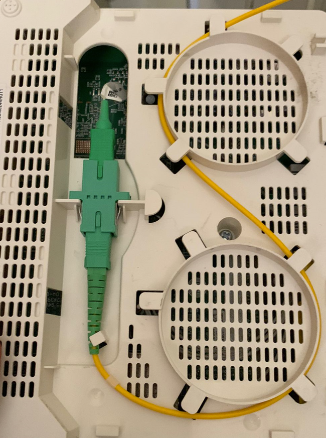

              mhijazi
              Yes. It is a GPON adapter. Unfortunately I can't test it now and the connection is internal and built-in inside the fiber gateway. So I was just checking if GPON adapters are compatible with Netgate hardware before getting one.
                mhijazi
                For your reference below
                  Ah, yes. Well it might work. Unfortunately we have no way test so I cannot be sure.
                  There have been a few threads about it here but I don't think anyone have actually tested it yet.
