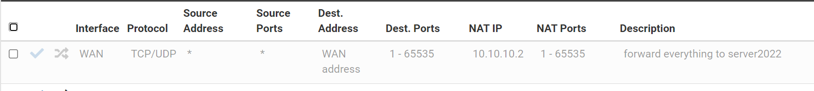

      However, when trying to reach the VPN from outside, they fail. For testing purposes, I have directed all TCP/UDP traffic from WAN to the server (see rule, now inactive), but even that doesn't work. What might be the cause?

        The shown NAT rule seems to be deactivated, as it's greyed out.

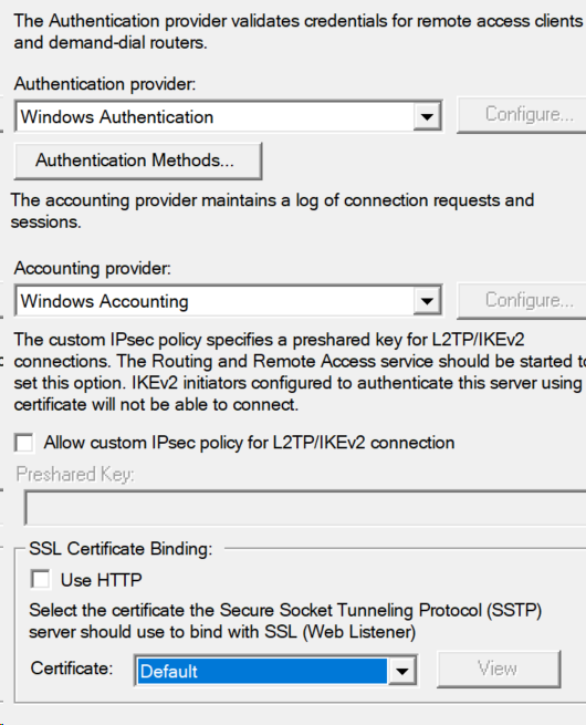

          @viragomann, it's pretty standard Windows (see pic). For protocol, I like SSTP but I am not dogmatic. As for the ports, the rule I showed above should NAT everything, right? And yes, I have deactivated the rule because I didn't want to block the access to everything else for a long time. But the problem persisted also with the rule active.
