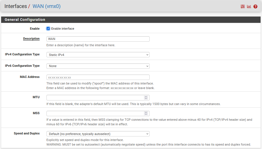

                I'm not that familiar with ESXi, is that showing it's linked at 100M-FD or it's set to that?
                If it was linked at that I'd expect to see ~100Mbps though it. If it;s set to that and the other end of that link is set to auto-select it's probably fallen back to half-duplex resulting in the speed you see.

                  Seems as though auto-negotiate is disabled on the esxi and Im unable to select 100Mb in the pfsense gui, only auto select is an option. Maybe I toggle the esxi link speed to 1000Mb????
