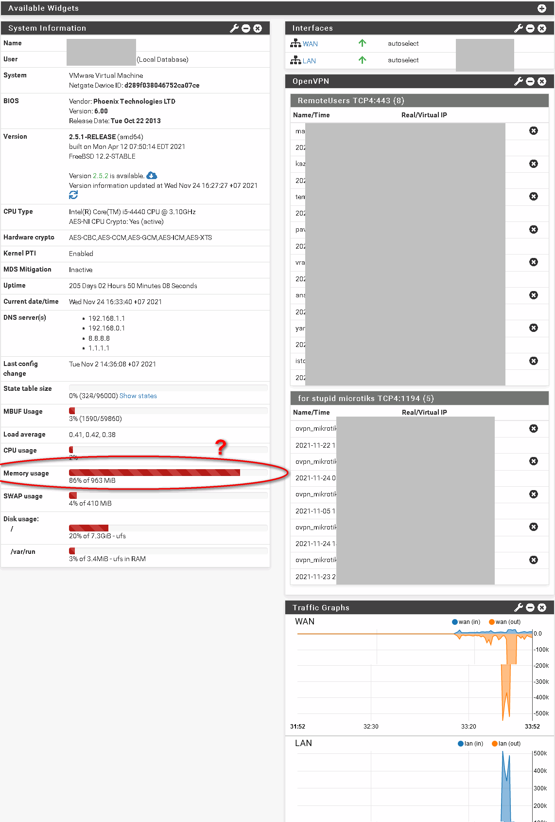

      Got pfsense 2.5.1 on VmWare esxi5.1 vm just to terminate several ovpns from mikrotik routers and road warriors.

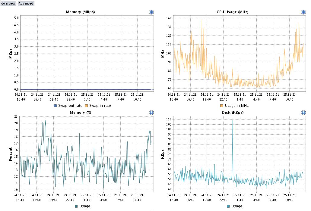

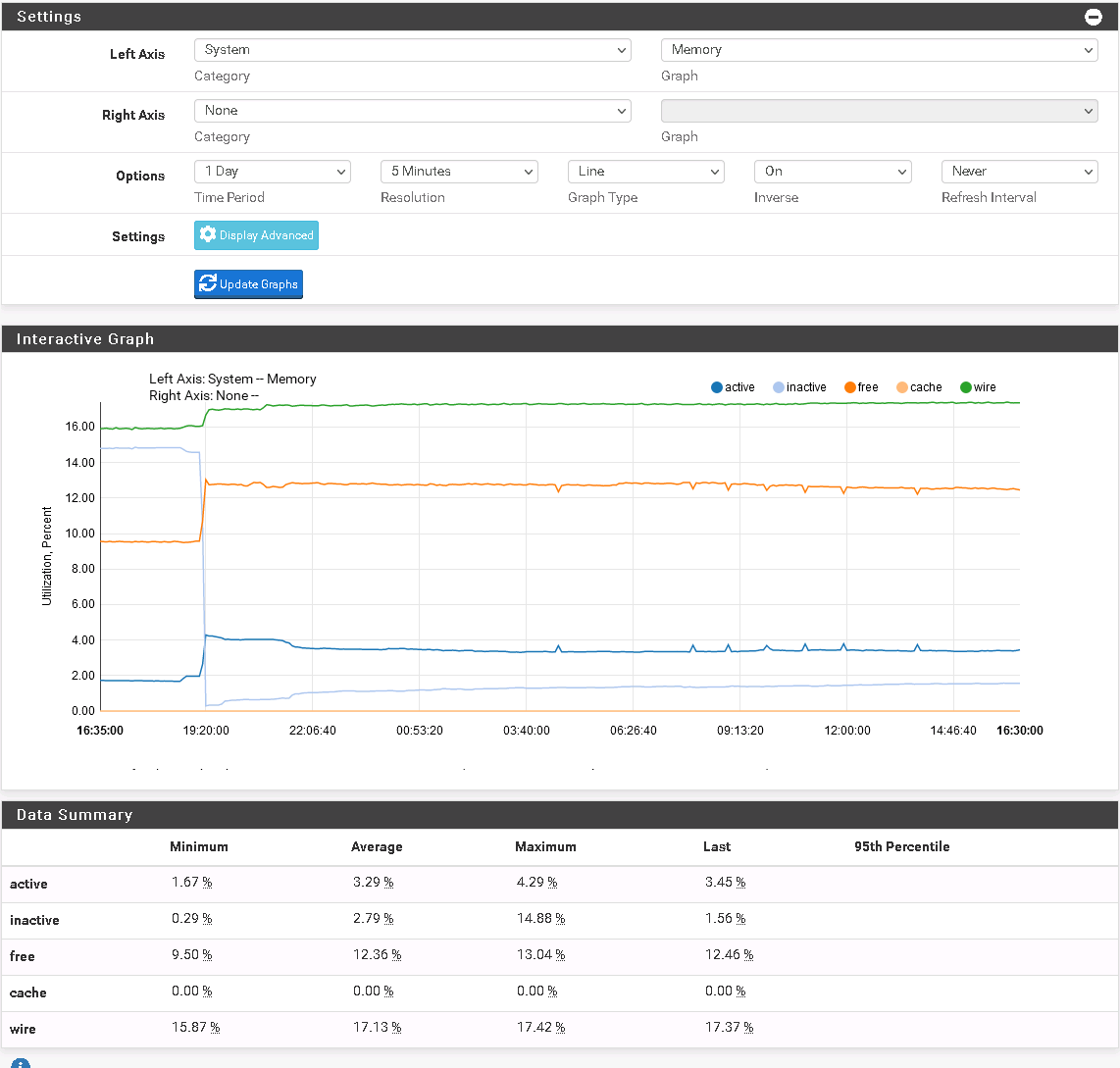

      Dashboard shows memory used 86%, but Status Monitoring shows ~16%. VSphere via vmware tools shows ~15% up to 20% peak.
      Why so strange readings on dashboard?

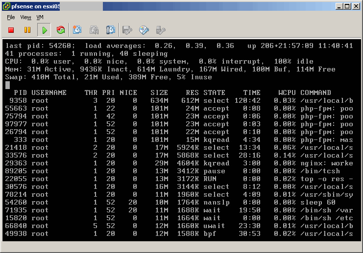

        Look at Diag > System Activity, or run it at the console: top -aSH.
        What is using that?
        Does it go back to something expected if you reboot the VM?

              No, it's not pcscd. Stopping it in services changes nothing.
              Looks like Dashboard takes in accouunt "Laundry" memory, but Monitoring is not.
              Looks like it's vmvare tools.
