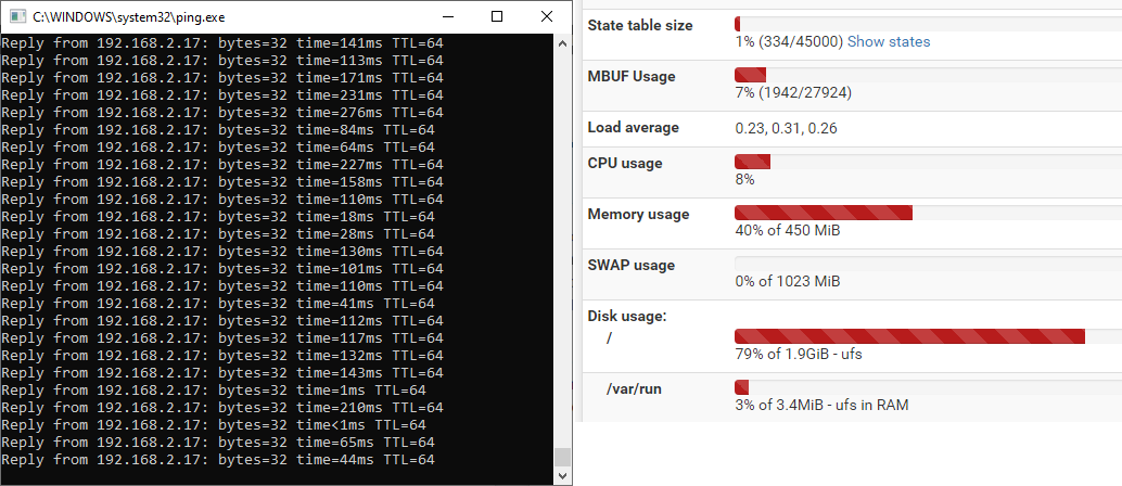

                                  sanketgroup @stephenw10
                                  ifconfig ue0 down; ifconfig ue0 up resolved the issue.
                                  Following is "System Activity Log" and few screenshots.

                                  • stephenw10S Online
                                    stephenw10 Netgate Administrator @sanketgroup
                                    Hmm, well I would definitely go back to the other device to remove the USB NIC from the equation. It looks like you are actually using le0 as LAN there though, not ue0. Did you run the ifconfig command against le0 instead?
                                    But I would still check a bare metal install first if you can.
                                      Yes I did execute for le0.
                                      But VM on bare-metal with onboard NICs (No USB NIC), should be okay, right?
                                        I would certainly expect that. There's nothing outside limiters that can cause latency like that in pfSense.
                                          Okay, I tried on totally new hardware with server-grade PCI LAN card (intel i350) and on VM.
                                          Still facing same issue.
                                            So you see the same thing both in a VM on new hardware AND running bare metal on that?
