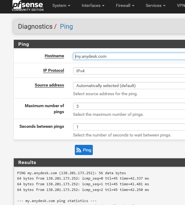

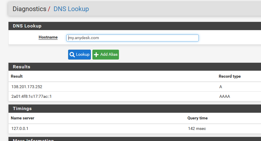

              For example, does the host name resolve ?
              Can you ping the host name ? Can you ping the IP 138.201.173.252 ?

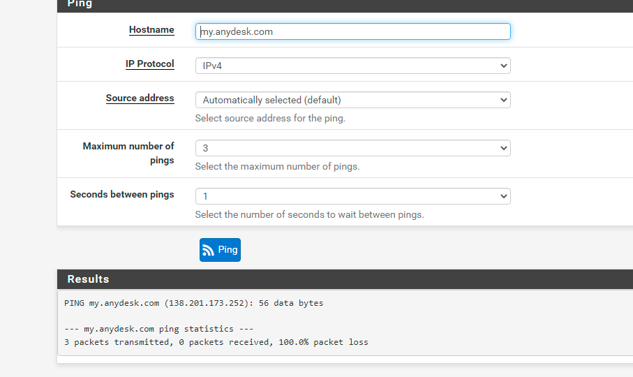

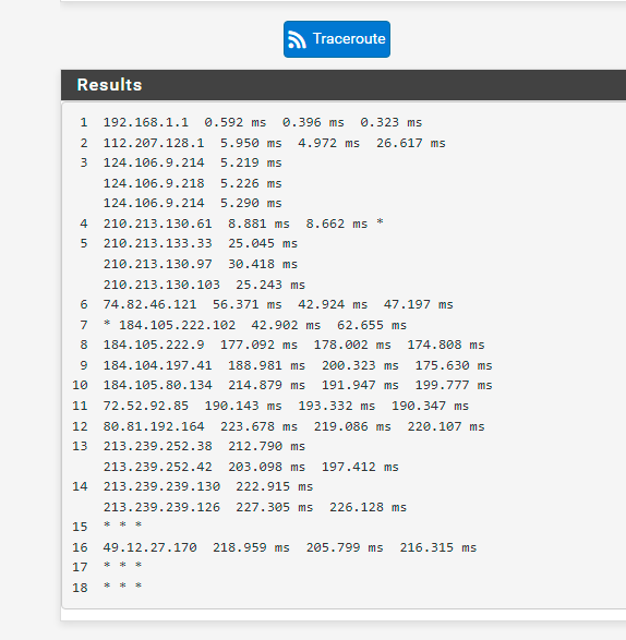

                  @stephenw10 Hi,
                  Sharing the screesnshot of the configuration in this temp link https://we.tl/t-7nJ3hozyy0
                  Also the ping and traceroute results.
                  Hoping that you could help me.

                    The IPv4 is ok. So resolving - DNS, works fine.
                    The traceroute also 'knows' there is an end point.
                    The (a) reasons you can not connect : your WAN IP isn't accepted.
                    You can exclude this reasons very easily : change your WAN IP ..... or use a VPN.

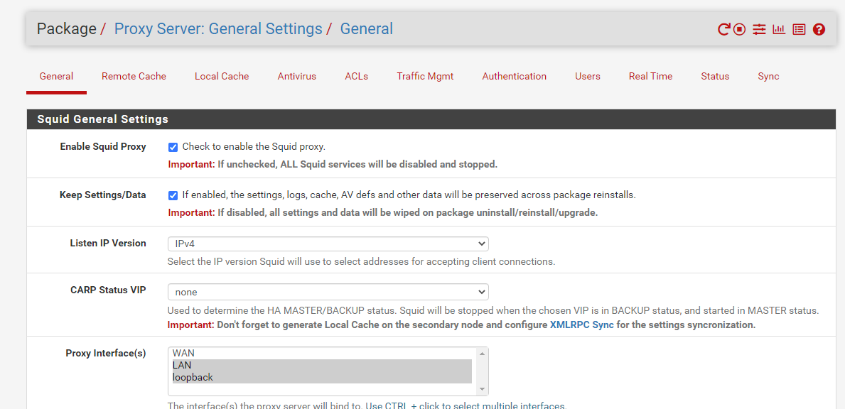

                      OK, so you have Squid running in transparent mode. That's certainly not default.
                      Does it connect OK without Squid?
