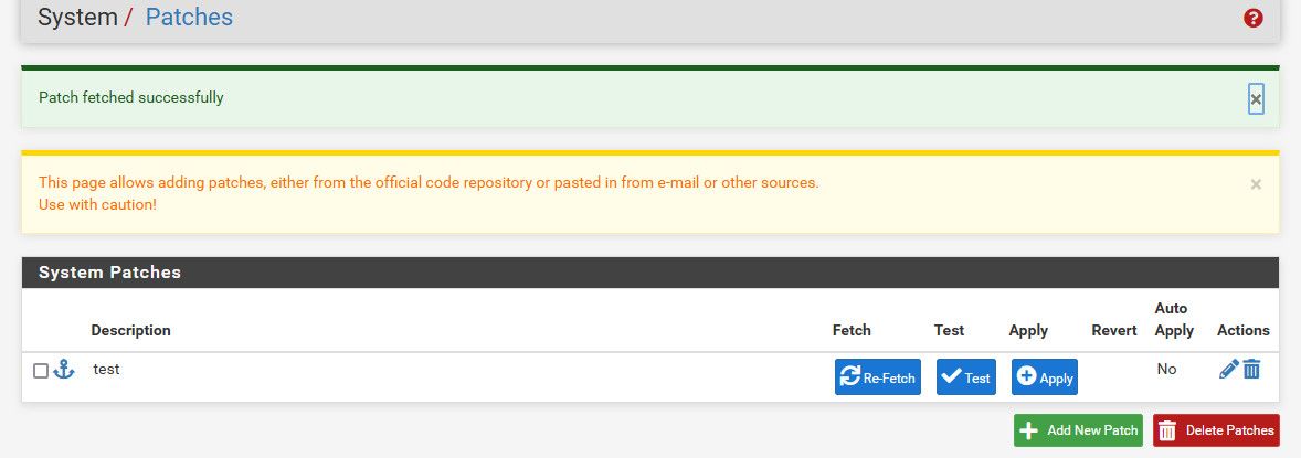

        I just tried to duplicate - and working here.
        I put in
        afcc0e9c97c1993ae6b95f886665fcb4375d26c7
        And it fetched just fine.

          @johnpoz Thanks for that. I did get it working, it was a copy/paste error - there was a space at the end of the commit ID. As soon as I removed that it started working. I will flog myself accordingly.
