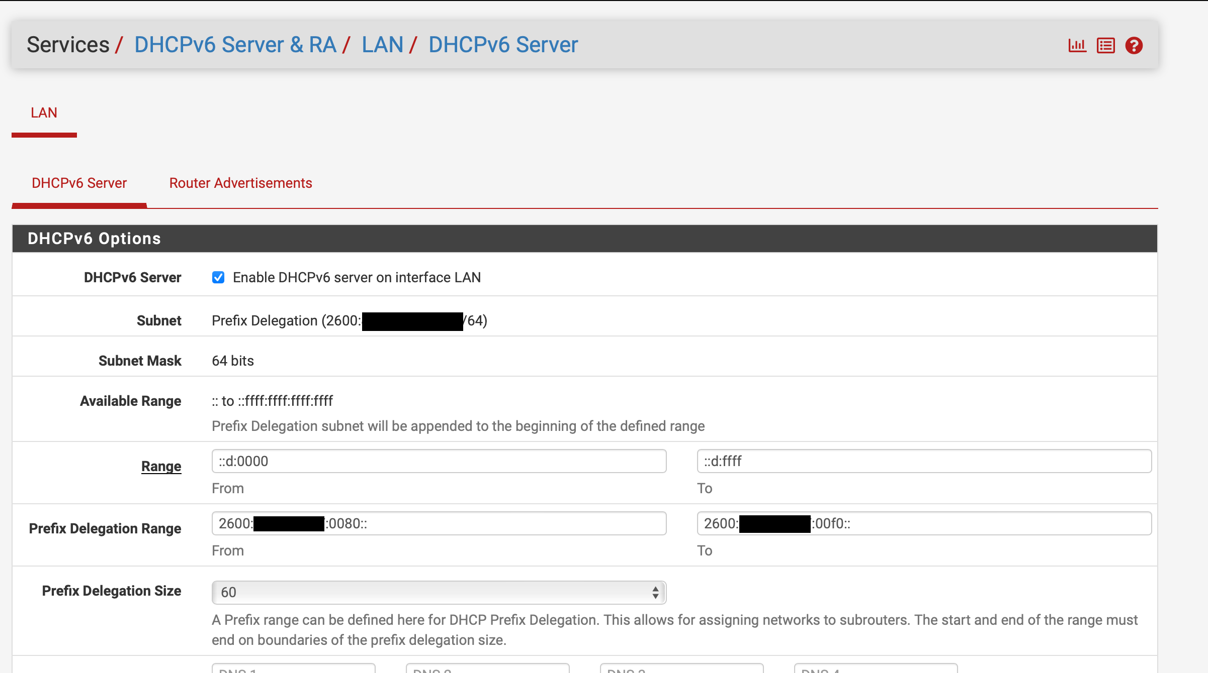

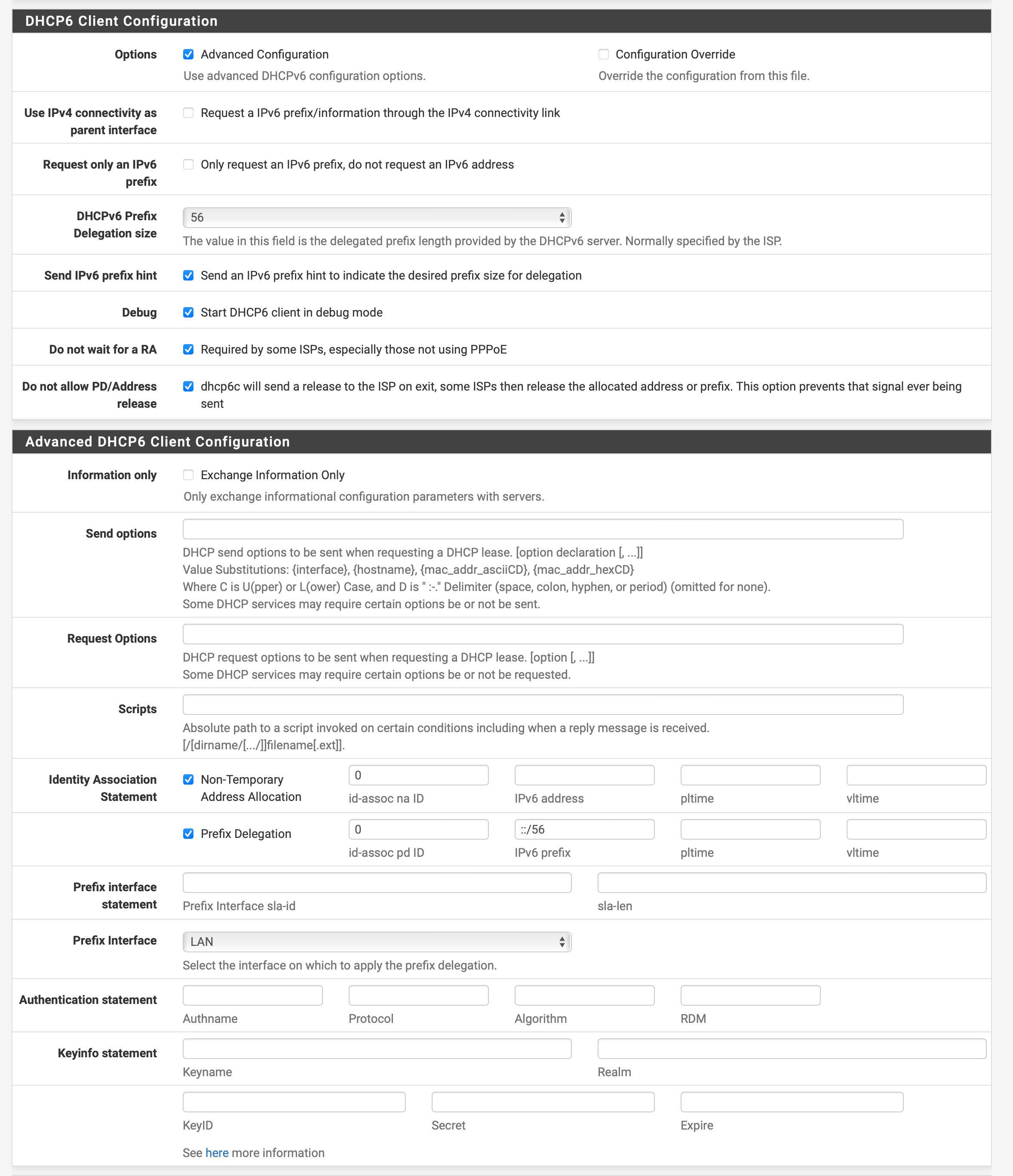

    Did my best to search the forums and larger Internet, and didn't find a solution to the problem like I'm going to lay out.
    I've been able to configure my WAN interface with a pd-hint /56, which my ISP (Cox) is happy to provide. The LAN interface is configured to track WAN, and as you'd expect a /64 is seen, and everything works just fine.
    Now what I'm looking to accomplish is a bit of a change, where rather than clients directly connected to the pfSense box, they're connected to a downstream router:
    pfSense <--->New Router<-->Various networks
    What I'm after is using pfSense's "Advanced DHCP6 Client Configuration" on the WAN interface, with prefix delegation, but using the "Prefix Interface" setting within to "Select the interface on which to apply the prefix delegation."
    Logic here is that pfSense will ask for /56 from ISP, but apply it to the LAN interface, and then within LAN DHCP6/RA config, I can hand out a /60 or two to the New Router.
    New Router is configured with pd-hint /60, and expectation is it will hand out /64s to the "various networks" behind it.
    tl;dr pfSenese pd /56 from ISP on WAN, applied on LAN, /60s to downstream router.
    Before going into the specifics of the WAN advanced config, is my logic sound? Thanks!

        @jknott Thanks for your reply. I'm exceedingly familiar with IPv6 routing and what you're suggesting. However, the goal here was use of PD end-to-end.
        pfSense's WAN configuration allows an advanced config to apply PD to another interface. With that interface snagging the /56, it would be possible to use DHCP6 config on aforementioned interface to provide PD downstream, i.e.:

            @asdjklfjkdslfdsaklj You can certainly do that, but there is no way for pfSense to know what the PD from upstream is so you have to add it to your DHCP6 server manually. And, if it changes, it needs to be updated manually. It cannot be updated dynamically.
            Delegating /60s from a /56 is starting to get into the realm that led to the original RFC recommendation of a /48 for every "site." When you properly ignore the 64 host bits and start trying to allocate prefixes downstream, 8 bits becomes not a lot of interfaces.
            Interfaces don't "snag" the delegated /56. It is routed.
                            @derelict after thinking about this for a bit, I could have phrased my intent better.
                            I had made a leap that after sorting out WAN dhcp6.conf I'd be able to "apply" the PD to the LAN interface's DHCPv6 config in such a way that the "Prefix Delegation Range" could be automatically derived and populated.
                            Get /56 from ISP, make it available to the LAN DHCPv6 config, assign something from that as southbound PD, albeit partially automatically.
                            I learned you need to specify the entire address in the PD range, and couldn't populate any part of it automatically. Here I've taken a /57 range from aforementioned /56, for southbound PD:
                            A way to say "provide a PD on the interface, of /x size, from WAN PD space" would be a nice feature.
