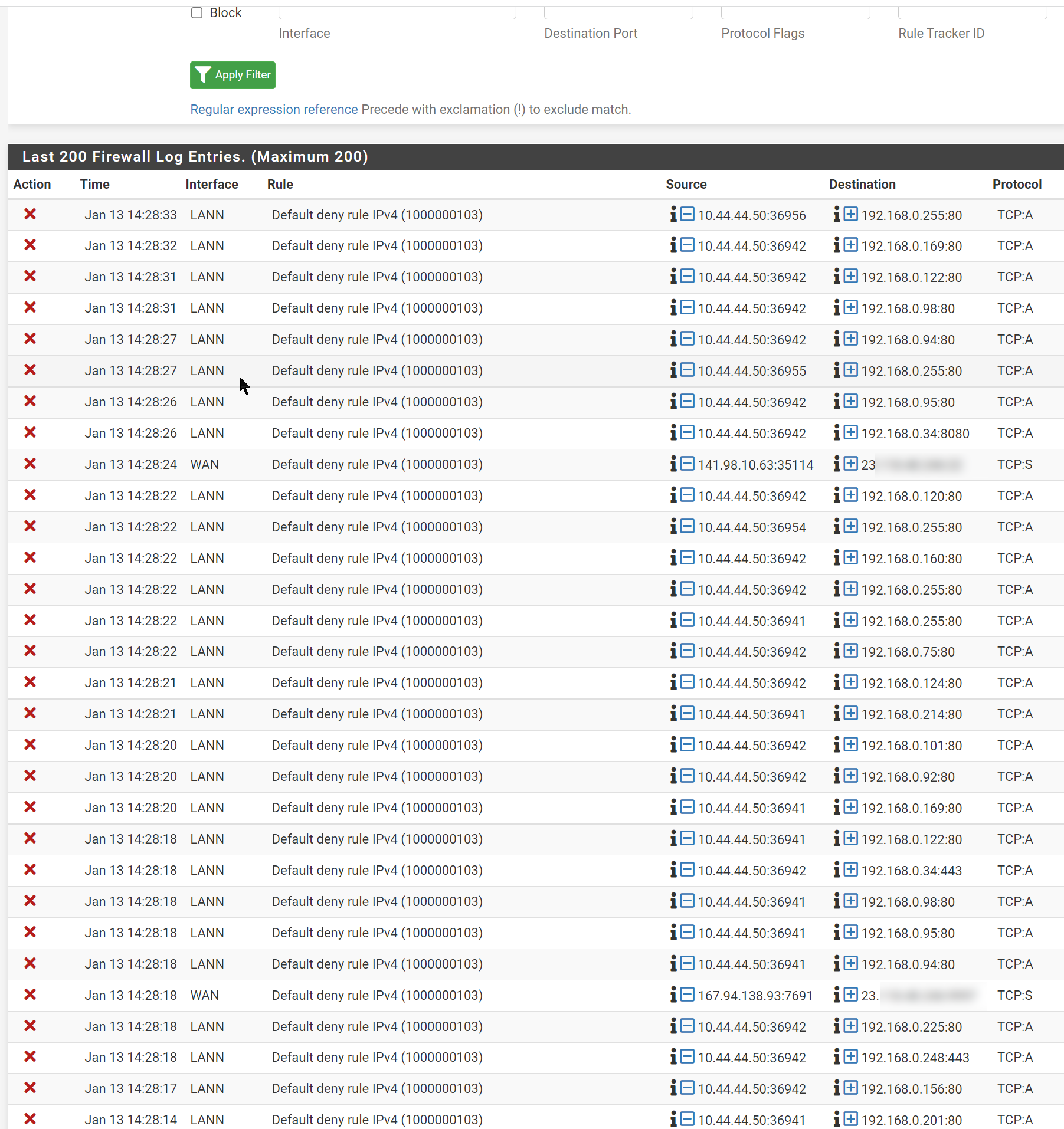

                        I looked again and am seeing a lot of weird entries... at least I don't understand them.
                        https://i.imgur.com/kub5EZB.png
                        Here is my laptop @ 10.44.44.50 being blocked by default rule... I don't understand how that's possible. As in -- the default rule would not apply to that traffic. And I also don't understand the GUI lockout.
                        • stephenw10S Online
                          The traffic hitting the default rule is doing so because it's out of state TCP traffic. It's all ACK traffic to a SYN the firewall didn't see. It implies you have some asymmetry in your network and that can produce odd behaviour in other ways. You should remove the asymmetry.
                          https://docs.netgate.com/pfsense/en/latest/troubleshooting/log-filter-blocked.html
                          The traffic hitting the GUI lockout rules is because that IP has attempted to login incorrectly too many times. SSH guard is similar for SSH connection attempts.
                          https://docs.netgate.com/pfsense/en/latest/troubleshooting/locked-out.html#locked-out-by-too-many-failed-login-attempts

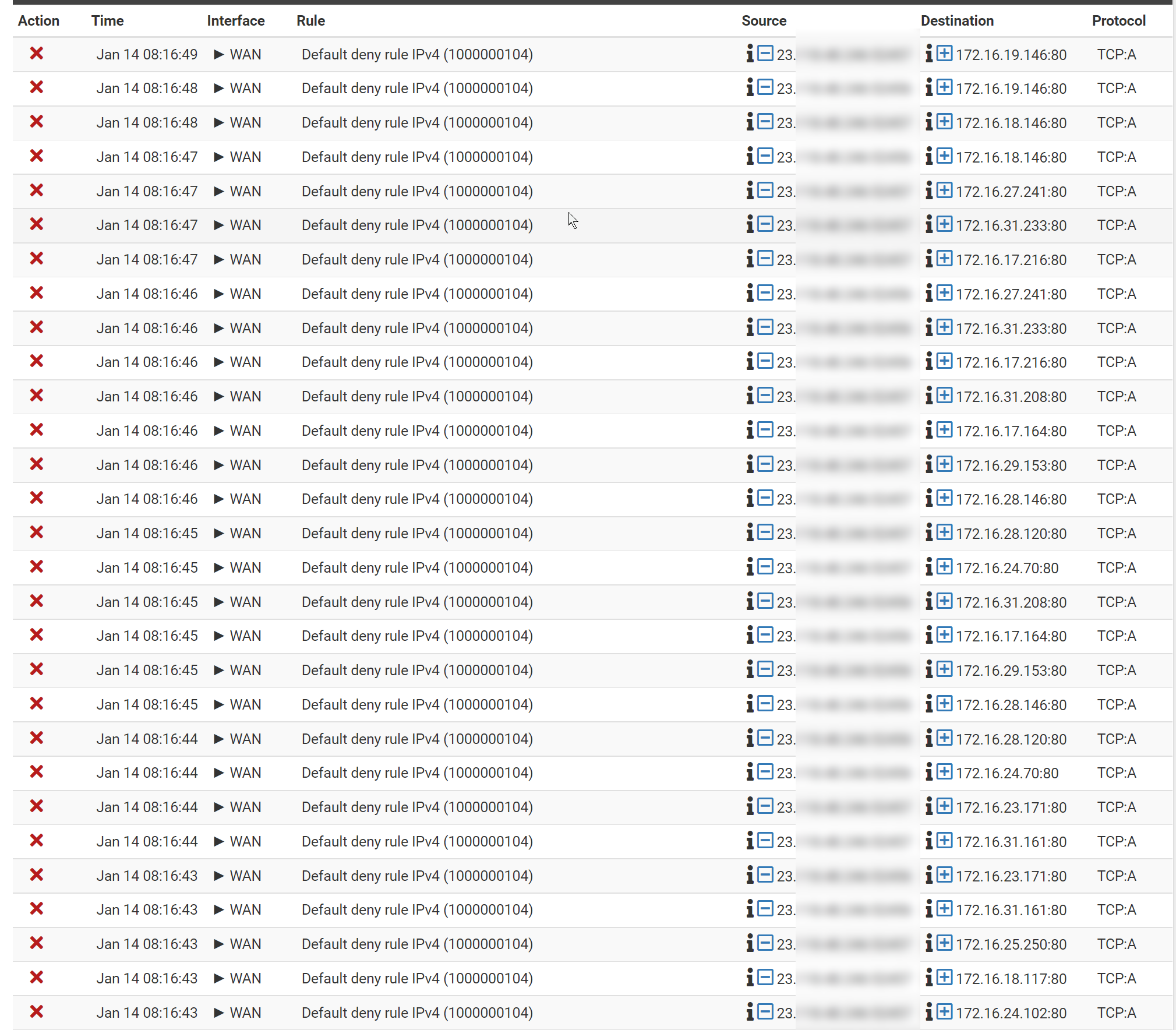

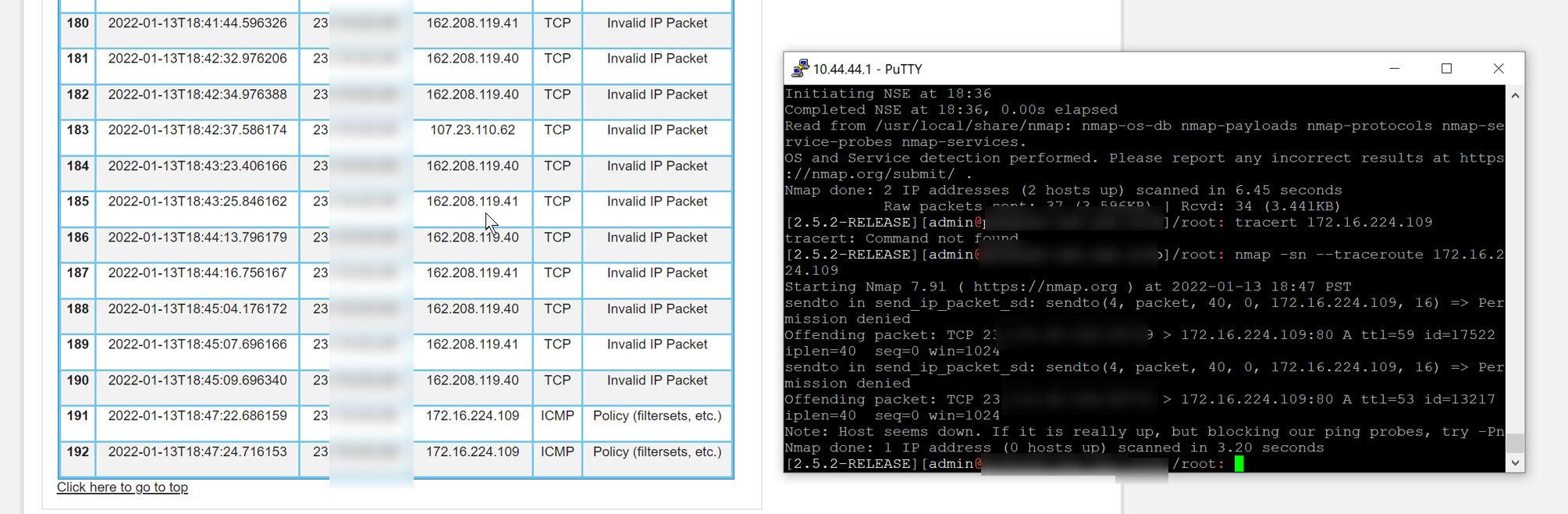

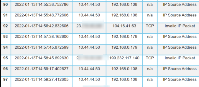

                            @stephenw10 I've been able to re-create this error while scanning the same subnet (192.168.0.0/24).
                            Additionally, another private address gave permission errors and interestingly enough there was a corresponding log in my ATT gateway.
                            **1e5f1186-7eeb-4518-af5a-801b841d57a7-image.png **
                            Here's my laptop being denied on LAN...
                            I tried to scan 172.16.0.0/16, but I'm doubly blocked by both the ATT gateway and pfsense outgoing-on-wan.png
                            Finally, not sure if related or not, but my laptop's private address somehow is appearing in the logs of the ATT gateway. a4761aea-e4ba-4555-a98b-75d52171301f-chrome_Iu9A7pCgM5.png

                              Yeah, it looks like you have some alternative route happening somehow. Laptop connected with wifi and ethernet maybe.
                              The blocked ACK traffic on LANN in the pfSense log implies it has not seen the preceding SA and possibly not the S either.
                              The 23.x.x.x is the pfSense WAN IP I assume? The AT&T device is using a different public IP?
                              The permission denied could be from the AT&T router responding with that.
                              Where is 172.16.224.109?
                              The AT&T device should never see traffic from the pfSense internal subnet unless you have something preventing outbound NAT for some traffic. It really looks like you have some second route between the laptop and the AT&T device that bypasses pfSense.
                              Run a pcap and see what traffic is actually passing pfSense when you see this.

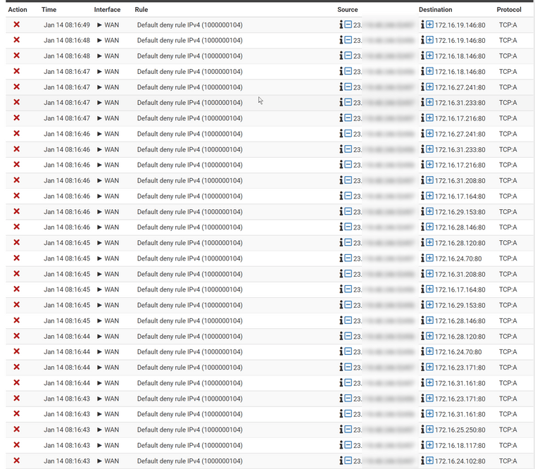

                                I ran a pcap on pfsense WAN as pfsense scans 172.16.0.0/13 and is generating TCP:A blocks outbound on WAN in the firewall logs.
                                I look at a blocked TCP:A outbound entry timestamped 15:29:00 within the firewall logs, and filter for that destination in Wireshark. (ip.addr==172.16.56.89). I do not see any traffic to or from any of the destination IPs shown in the firewall logs.
                                Edit: Where is 172.16.224.109?
                                I don't know, it's not something that I've provisioned and well outside my address ranges. I use 172.16.0.0/24 for guest wifi access and that's not seen activity in some time. I saw that address in the AT&T gateway logs and was curious for this reason. AT&T gateway has everything related to firewalling and packet filtering disabled yet it was showing reason: filtering.
