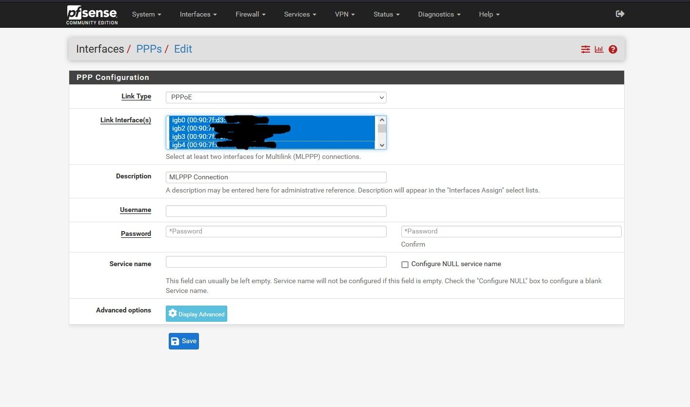

                      Yup.. MLPPP is a single WAN solution. The MLPPP instance happens on your pfSense box so all of your modems (up to 8) would be in bridge mode. No double NAT.
                      The trick is to get an ISP to handle the other end for you. I gave my ISP at the time some documents and they took it on. (charged way to much but I digress..)
                      Very easy to setup on the pfSense end-

                          Yup. 😸 https://docs.netgate.com/pfsense/en/latest/multiwan/mlppp.html
