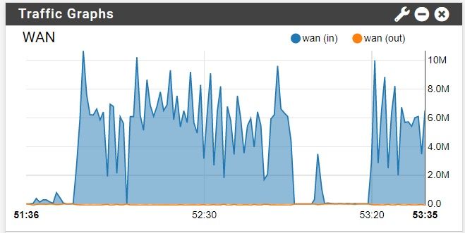

      ... but now I have unregular dead times of several seconds which lead to big issues for streaming, gaming etc:
      I know that so far I have provided very poor backround information but first of all I need some idea of what could cause the issue and how to start up with the troubleshoouting.

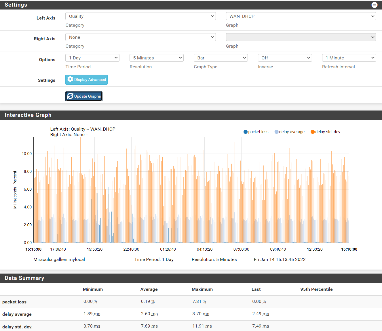

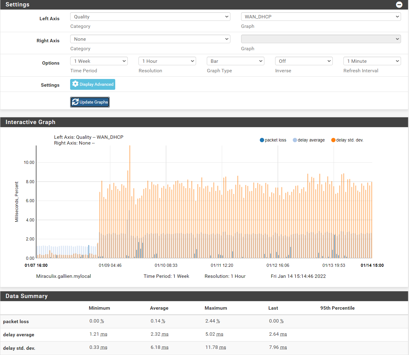

              There is a data loss in the history of the connection to the gateway (which is here the fritzbox)
              shown in the weekly and daily history graph:
              Last day:
              I would interprete it that the connection to the gateway is instable from time to time.
              But what could be the reason???
              Do you have any idea or any further steps for investigation?
              Thanks so far ;-)
              Cheers Migo
