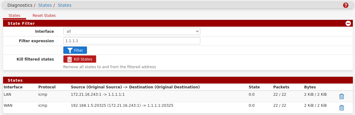

                • stephenw10S Online
                  If you ping 1.1.1.1 from a client on LAN and then look for that in the state table you should see something like this:
                  So a state allowing it in on LAN and another state allowing it out on WAN and also NATing the source to the WAN IP (also a private IP in my example).
