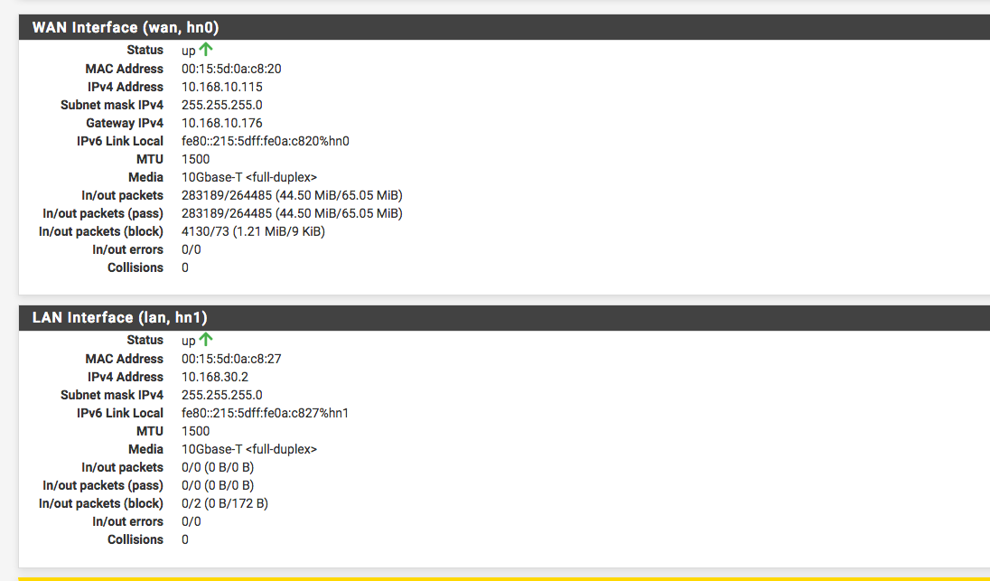

                      hamsterray
                      this is my Hyper-V Nic,
                      problem temporary resolve after i downgrade the PFSense to 2.5.2
                      i export setting from 2.6.0 and import to 2.5.2 and upload speed is back to normal
