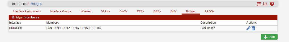

As you can see by the pic I have LAN under the LAN-Bridge, I had alot of nic's lying around so I made my own firewall. I also just bunched everything together because I don't know enough yet on how to created different networks, i need all these systems to talk with other.
OPT1 and OPT2 are windows servers, LAN is a TP-link switch, OPT5 empty, OPT6 is a UNIFI UAP AC Pro, HUE is the hub, and HA is Home Assistant that runs the house.

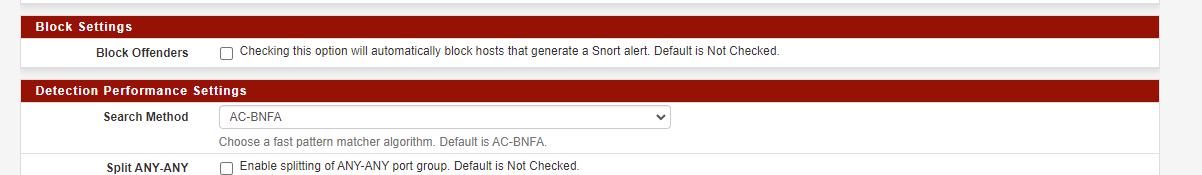

I turned off the snort blocking setting and it worked. Thanks
By turning this off does it leave vulnerable anywhere?
I had to completely turn off snort and clear all the block list.
I like to use snort but there must be something I am doing to block all these OS's update.
Like I said if you just load all the rules and don't tune anything it will alert and block on most Linux pkg updates. You need to suppress the alerts or disable the rules that are triggering it. https://docs.netgate.com/pfsense/en/latest/packages/snort/suppress-list.html
We usually recommend running Snort for a least a week in non-blocking mode whilst monitoring the alerts. Only enable blocking once it's no longer alerting on legitimate traffic.
