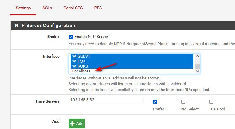

                  interface listen lo0
                  And I can query on loopback just fine.. That is for the ntp come up as server on loopback.. Which is really kind of pointless ;)
                  Do you have vip or something setup there?

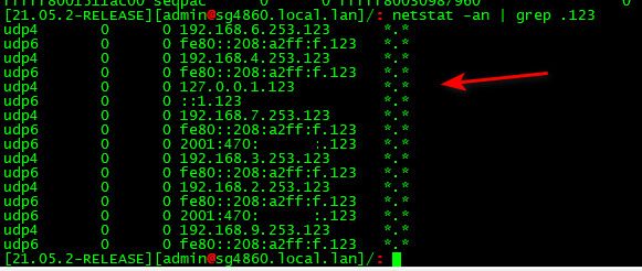

                  I don't have loopback selected, but still show 123 listen on loopback

                    We me, "udp4 *:123" overlaps even "udp4 127.0.0.1:123".
                    root     ntpd       51142 21 udp4   *:123                 *:*
                    root     ntpd       51142 32 udp4   127.0.0.1:123         *:*
                    when I de select 'Localhost' I still see :
                    root     ntpd       68960 21 udp4   192.168.10.3:123      *:*
                    root     ntpd       68960 23 udp4   192.168.1.1:123       *:*
                    root     ntpd       68960 26 udp4   192.168.2.1:123       *:*
                    root     ntpd       68960 29 udp4   127.0.0.1:123         *:*
                    root     ntpd       68960 31 udp4   192.168.3.1:123       *:*
                    Nice .... !?!
                    Btw : IPv6 : the same thing : "udp6 ::1:123 :" stays in place.
                      dweimer @Gertjan
                      @johnpoz
                      I removed the loopback interface from the listen on list, no change in behavior still shows its listening on 127.0.0.1:123 as well as ::1:123 but still can't connect. to 127.0.0.1 I did test, DNS is listening on 127.0.0.1:53 and I can't connect to it either.
