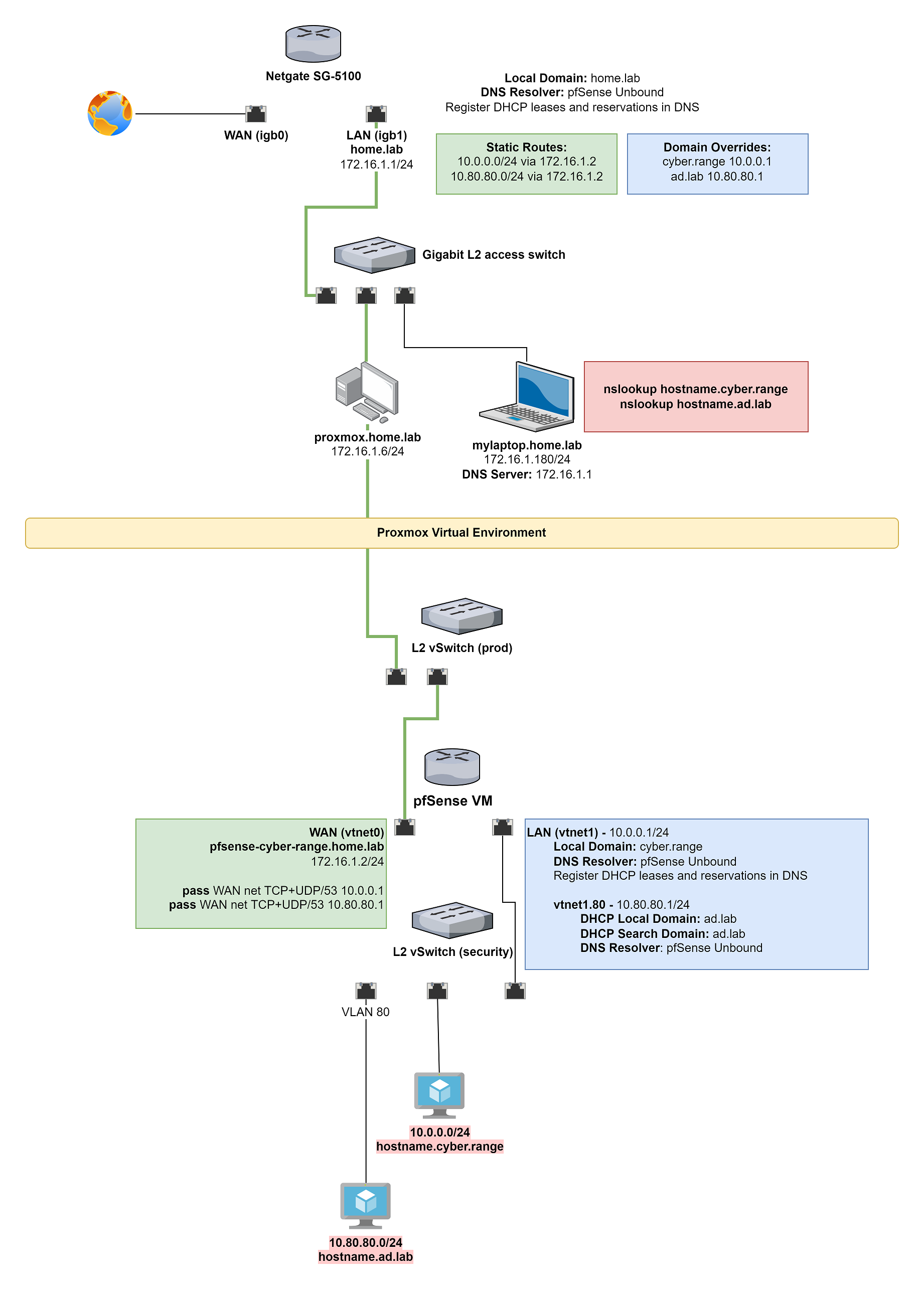

@johnpoz Thank you for taking the time to reply. I have configured static routes on the SG-5100 (172.16.1.0/24). Route to 10.0.0.0/24 via 172.16.1.2 and route to 10.80.80.0/24 via 172.16.1.2. I should have specified the WAN IP on the pfSense VM is 172.16.1.2
10.0.0.1 is the default gateway for the native VLAN under the pfSense VM. 10.80.80.1 is the default gateway for the
ad.labVLAN under the pfSense VM.In my head, I am thinking, a host on
10.80.80.0/24would send DNS lookups 10.80.80.1/24 to resolve anything under thead.lablocal domain. Since, the pfSense VM is providing DNS resolution for DHCP leases and reservations, my first instinct was to route DNS requests forad.labfrom172.16.1.0/24to10.80.80.1, since that is the gateway for that VLAN.Not sure if this is the right way to think about it, but that's what I'm hoping to learn here.

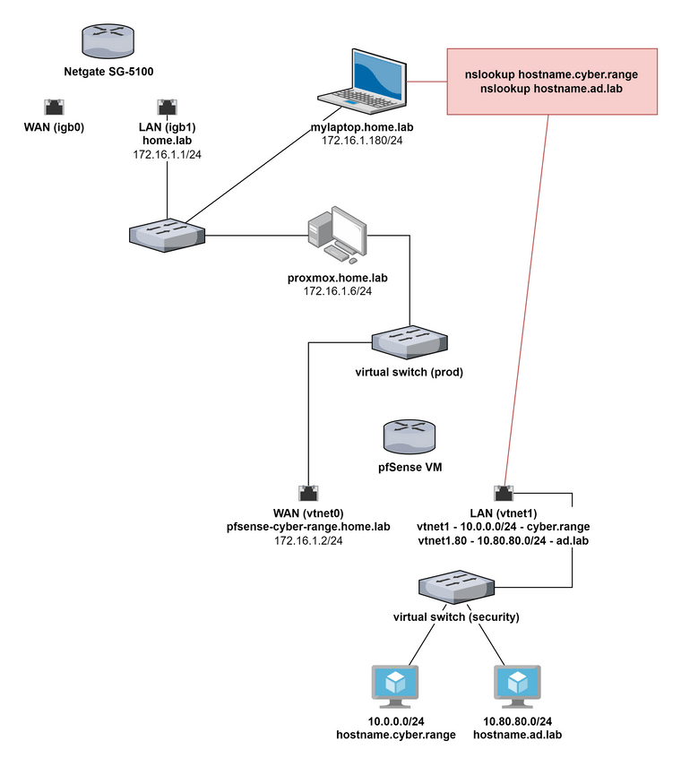

Here's a more accurate map of the network

@johnpoz Firstly, thank you for your time and diagram. I don't want it to seem like you have to wrangle details out of me. I am trying my best to straddle the line between too much information, such that the details are lost in the mix. I appreciate your patience and you working with me here.
I sincerely hope this iteration of the diagram would improve your understanding of my setup.
- On both sides where pfSense is deployed, pfSense is both the DHCP server and the DNS resolver (Unbound)
- I already had the static routes in place
- Routing is good, connectivity good
- I can reach the ports on the specified IPs
- I tried my absolute best to work with the domain overrides, but couldn't get it working
If you refer to my latest iteration of the diagram, it should clearly indicate:
- The DNS resolver setup
- The DNS server on the client
- Static routes into the upstream NAT network
- Firewall rules to allow TCP+UDP/53 into the NAT networks
- The domain overrides I attempted on the downstream router

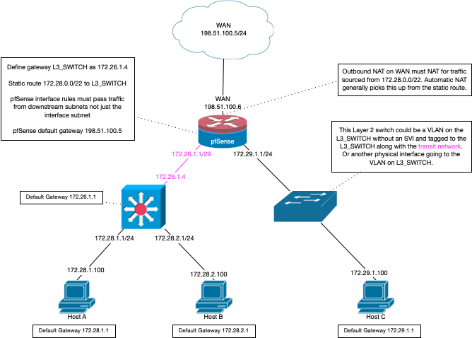

If you want your laptop to resolve some cyber.range fqdn and get the IP of the device behind your downstream pfsense then you would need to setup routing. But if your going to route you should not use this 172.16.1 network as the transit or your going to run into asymmetrical issues.
Oh I see you do have some routes setup.. Did you turn off natting in pfsense vm? Again routing with 172.16.1 is bad idea, you need a transit network (no hosts).. See the drawing I posted on how to do downstream router.
