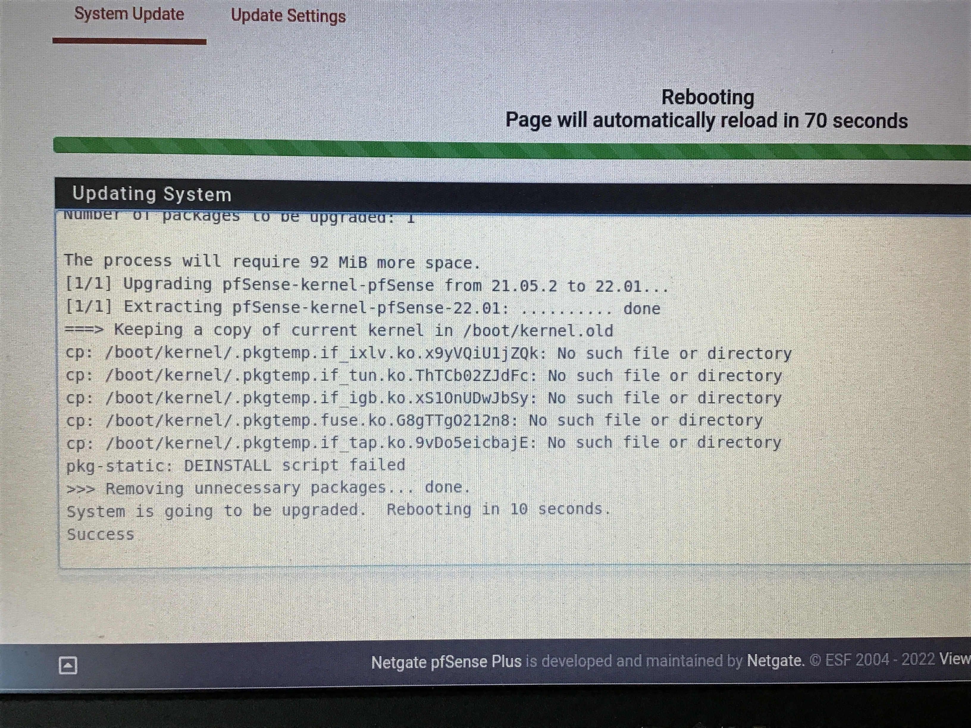

      I've been following the other threads regarding no internet access after upgrading to 22.01 and wanted to share my experience in hope that it might provide some additional clues as to what is going on.
      Upgrade to 22.01 on a SG-5100. Install completed with the following errors (packages were not updated prior to upgrade):
      • It rebooted fine and established a VPN connection without issue.
      • Internal network and VLANs out through the VPN all worked normal. However the VLANs routed to the WAN had no internet access. I could ping the gateway but no external sites.
      • A port configured with WAN access (direct WAN access, not through VPN and not configured as a VLAN) worked as expected.
      • No limiters are in use.
      • Tried a fresh install from image with the same known good config file running fine on 21.05.2 and got the same connectivity results.
      After messing with it for several days I had to get things back up so I reverted back to 21.05.2 and all is running normally.

      • stephenw10S
        Those errors shown are expected, nothing that will cause an issue.
        If you can ping the WAN side gateway but nothing beyond that it's probably an outbound NAT issue. I wouldn't have expected anything to change between 21.05.2 and 22.01 there though.
