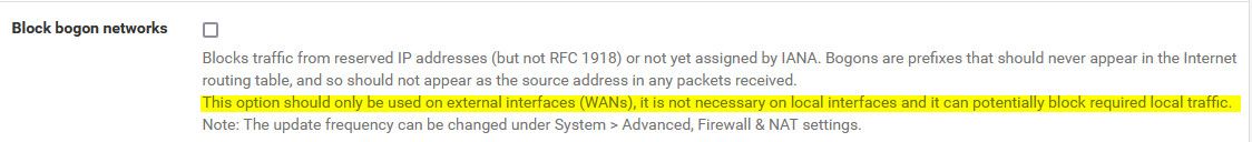

                    johnpoz LAYER 8 Global Moderator @hellegaard1
                    @hellegaard1 why are you blocking bogon on your own local networks? You understand bogon include rfc1918 space.. There is ZERO reason why bogon should ever be selected on a local side interface.
                    Remove that for starters.. And while pfsense might remove rfc1918 from it - by definition rfc1918 is bogon.. Again not something you would ever set on your own local networks interfaces..

                      he said it pings accross... so im not sure if the bogon also shouldnt block icmp ?
                      <a href="https://carsonlam.ca">bintang88</a>
                      <a href="https://carsonlam.ca">slot88</a>
                      johnpozJ H 2 Replies Last reply Reply Quote 0
                        johnpoz LAYER 8 Global Moderator @pete35
                        @pete35 true - but it should NOT be there, period.. Zero reason - and even in the notes clearly states should only be on wan interfaces.. Why would anyone have clicked that to be enabled without a clue to what it is or does..
                        Clearly that is blocking some traffic you can see by the non 0/0 in the states table - so its been evaluated and triggered.
