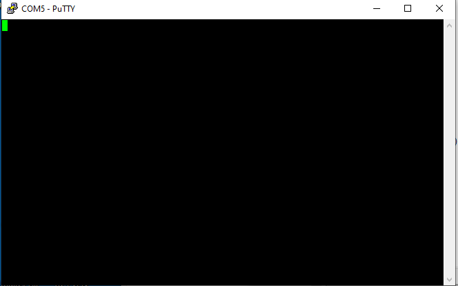

      We've purchased a bunch of these for VoIP deployment across 9 offices. We had one crash about a year ago and now we have another that seems to run fine however if we reboot the device it takes hours or days to come back up. Connecting to it through the console port it's a blank screen in putty using a console speed of 115200 and the correct com port in device manager.

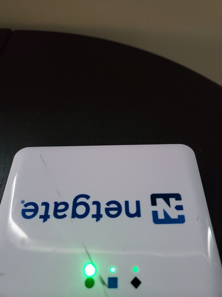

              @stephenw10 that is correct, I get an amber light on the top of the unit but putty just shows blank screen. I'm going to leave it for a day and see if it comes up eventually. The factory reset button on the unit also does nothing.

                      stephenw10 Netgate Administrator @rustydusty1717
                      @rustydusty1717 said in SG-1100:
                      There is no amber LED on the SG-1100, there are all green.
                      On the PSU maybe?
                      Which LED?
                      There is really nothing on the console at power up?

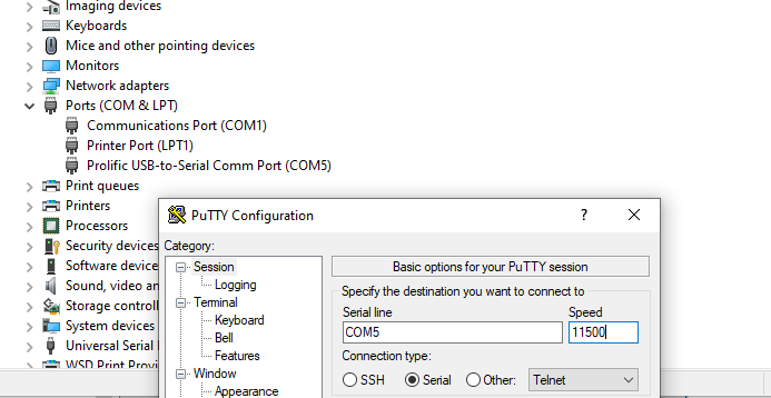

                          I will have to try that. It will eventually come back to being functional but it can take a few days. This is where it's currently at after being plugged in for 1 day.20220302_144410.jpg netgate1.PNG netgate2.PNG

                            @rustydusty1717 It’s probably only your screenshot, but that datarate in putty is wrong and will cause a black screen and no reaction to key presses. The speed needs to be 115200

                              @rustydusty1717 But really. With putty connected at 115200, remove power from the device, wait 10 sec and apply power again. Then youll see if it completes hardware post without issues and starts to boot. There no point in waiting another day as youll get nothing from it actually comeing “”online”.

                                rustydusty1717 @keyser
                                @keyser it is that screenshot I am indeed using 115200.
