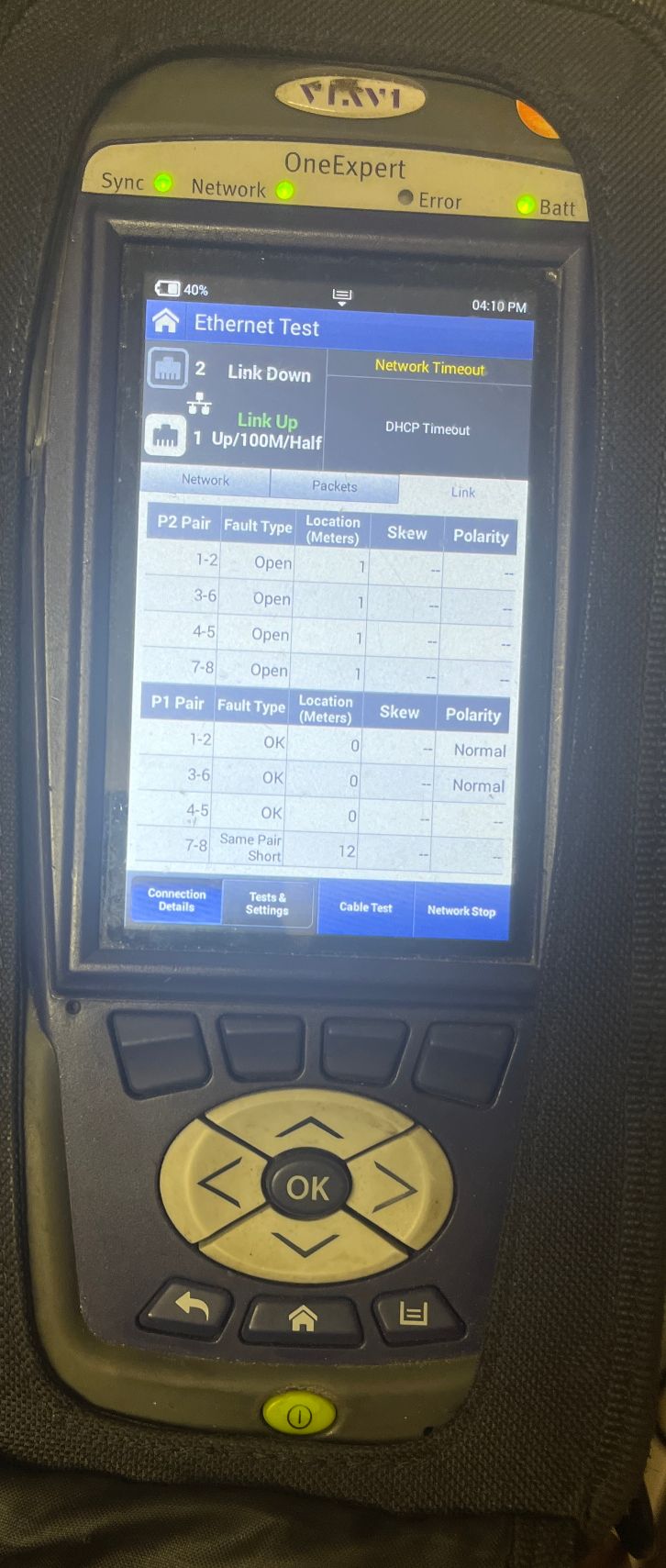

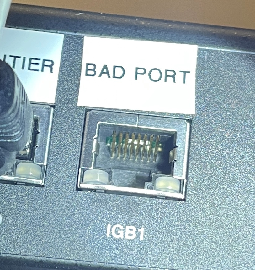

      We have an SG-5100 purchased in 2020. An ISP tech came out today to troubleshoot why our internet has always been unreliable, and he discovered that our firewall has a short on pins 7 and 8. We tested the cat6 cable on a different device to rule out cable problems. Then we noticed that the firewall port was only auto negotiating 100baseTX half-duplex. I assume our warranty on the SG-5100 has expired since it's about 2 years old, but is there any advice or assistance for us? I guess I could stop using that broken IGB1 port and configure one of the spare IX ports as our new WAN, right?

                @jeremy11one Did you get some magnification and light and look at the pins? I recall fixing a port at one time that had flipped a couple of pins together. Flipped it back into its proper spot with a small tool and it was good to go. This is anecdotal and not 5100-specific.
                Chattanooga, Tennessee, USA
                  Jeremy11one @Derelict
                  @derelict Good idea. I checked, but the pins look good.
