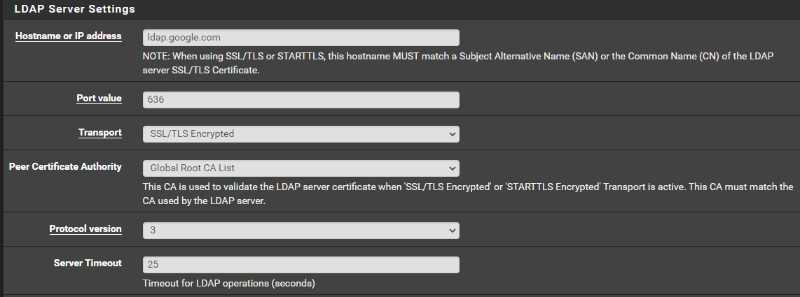

      I suspect this issue has to do with the fact that it's not using the certificate.
      Both of guides I noted above shows that I can choose a certificate when setting up a new Authentication server, but I do not see this option. See below:

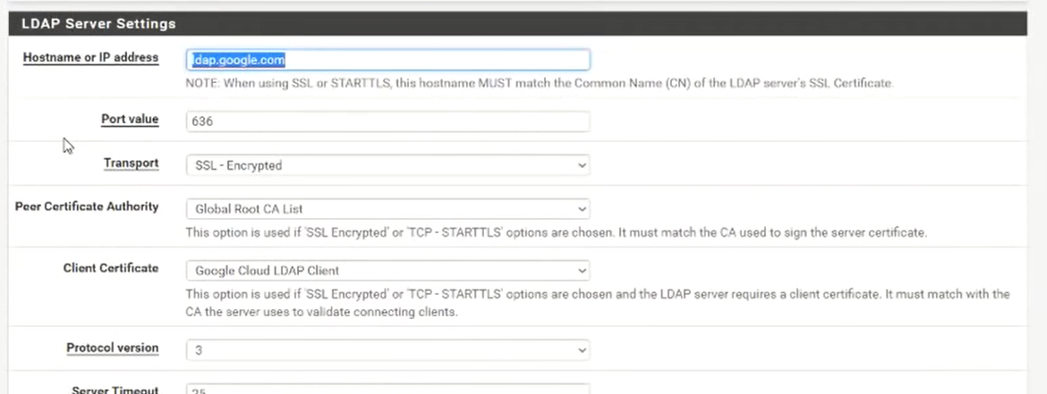

      Example from the video guide shows a section called Client Certificate:
        Because like is says there the client cert option in the GUI is only in Plus (Factory).
        If you're running CE you need to use Stunnel:
        https://docs.netgate.com/pfsense/en/latest/recipes/auth-google-gsuite.html#install-the-stunnel-pfsense-package-ce-or-2-4-4-release
        But you can now also update to 2.6 and then upgrade 22.01 on your existing hardware. You will then have that option.
