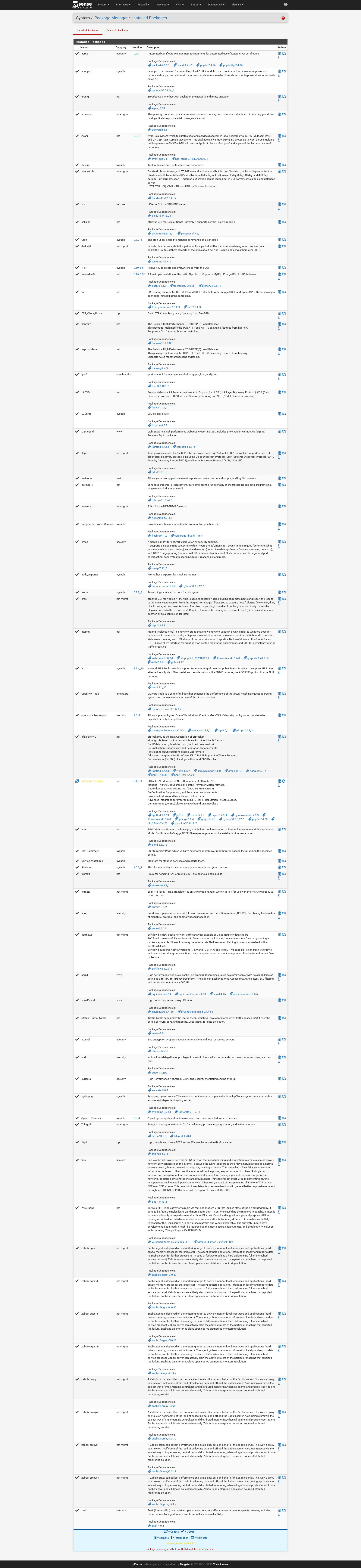

                        And now for some humour :
                        The System > Package Manager> Installed Packages page :
                        The image is to big for the forum - so I self hosted it here
                        So pfSense says to me : You have installed ALL the available packages ....
                        ?? Mammmmmmaaaaaaam !!! pfSense thinks I'm nuts.
                        I should stop messing around.
                        Upgrading to pfBlockerng-devel 3.1.0_2 worked ... slowly, a couple of minutes for a 2Mbytes file.
