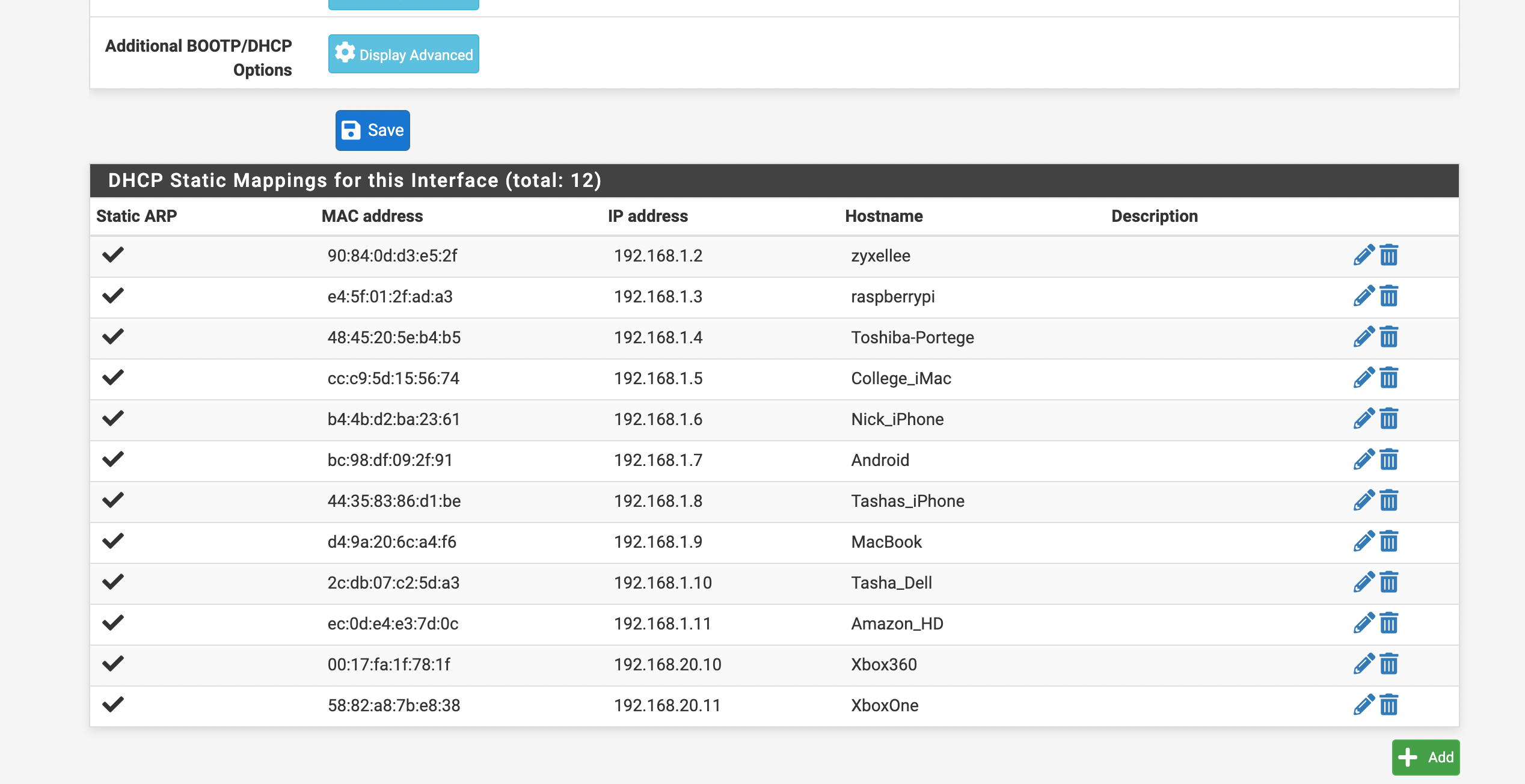

      I wanted to test adding in the firewalls IP address and MAC as a static entry so it stops doing this located here.
      I added it in however I received errors 'arp: writing to routing socket: Operation not permitted'
      Are we suppose to add in the firewalls IP and MAC? If this is done automatically why is it not listed as an address in the DHCP server already?

        The second images shows your static DHCP leases, use by a DHCP server that servers your LAN(s).

          @gertjan I tried to change my layer 2 address of the pfsense wan port to be the same address as the modem to see if this could resolve my problem. However, this course of action killed the WAN connection. I have resolved this with a different post, thank you for your reply. I was told to contact my ISP to report this and turn off logging same as what you recommended.
          The I added it was I added a static entry to try to resolve this within the DHCP server on the firewall itself for this post.
