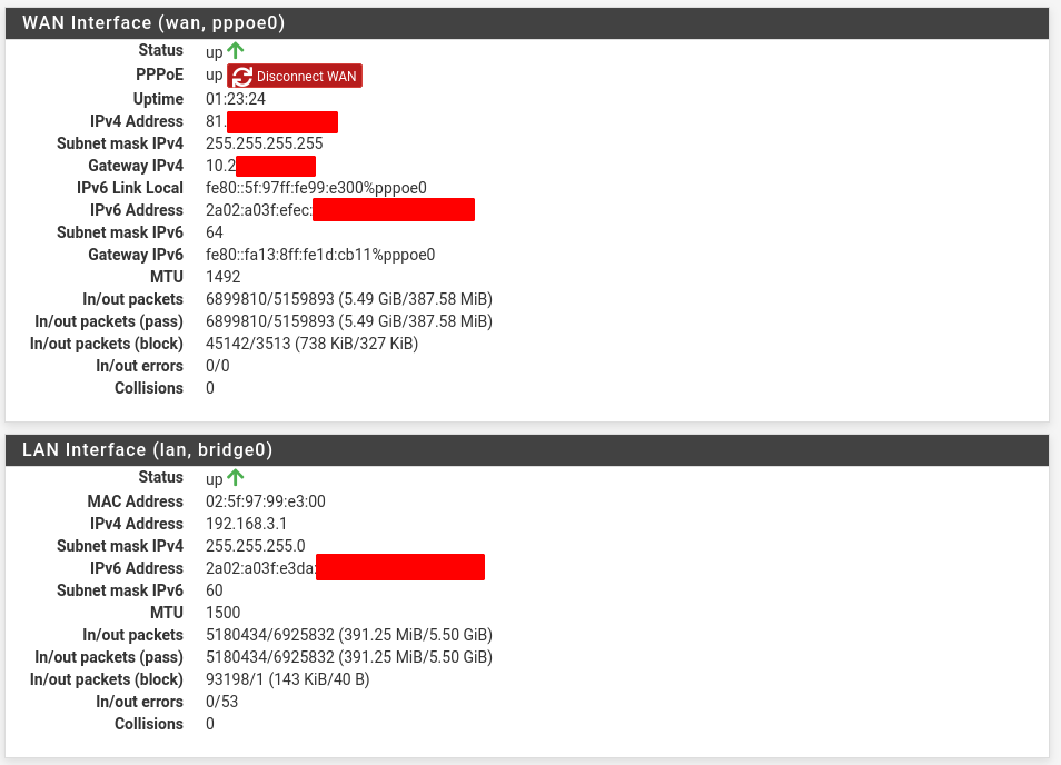

WAN defines a /64 subnet, the network part being (generalized):
2a02:1234:5678:9abc::
LAN defines a /60 subnet, the network part being (generalized again):
2a02:1234:5abc:def0::
I kept the same parts the same, but don't want to expose the network part too much.
Starting from /36 it seems to differ. Meaning (As I got to understand ipv6, different networks)Problems:

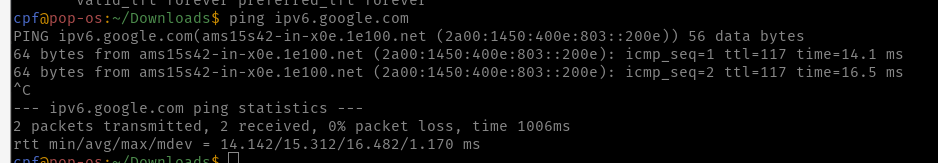

When going from 2.4.4 to 2.6.0, I noticed my ipv6 setup was broken, so I started tinkering.
Multiple full factory resets later, and an upgrade to 2.7.0-DEVEL (Tue May 17 06:19:29 UTC 2022) I had managed to get ipv6 fully running. The local network was able to access/ping ipv6 addresses, and received appropriate leases (From what I assume was the dhcpv6 server)

Both WAN & LAN have an ipv6 address now, but the internal network no longer receives any ipv6 addresses.When tracking down what could be the cause for the internal network not receiving any dhcp6 leases, I stumbled upon the error message:
The specified range lies outside of the current subnet. Skipping DHCP6 entry.The range defined in the dhcpv6 server is the default (From: "::1000", To: "::2000")
The dhcpv6 server identifies the prefix delegation as being:
2a02:1234:5abc:def0::/60(The same network as the LAN bridge)
The Subnet mask defined is 64 bits there though. Since it should be part of the overall subnet of LAN, it should work though.

@cpf Your LAN should be /64. Why is it different with you? Have you looked at Status - Interfaces - LAN?
@bob-dig That's where I get the /60 information from
@cpf If LAN is on Track Interface, it should be a /64. If not, something seems fundamentally broken in your config.

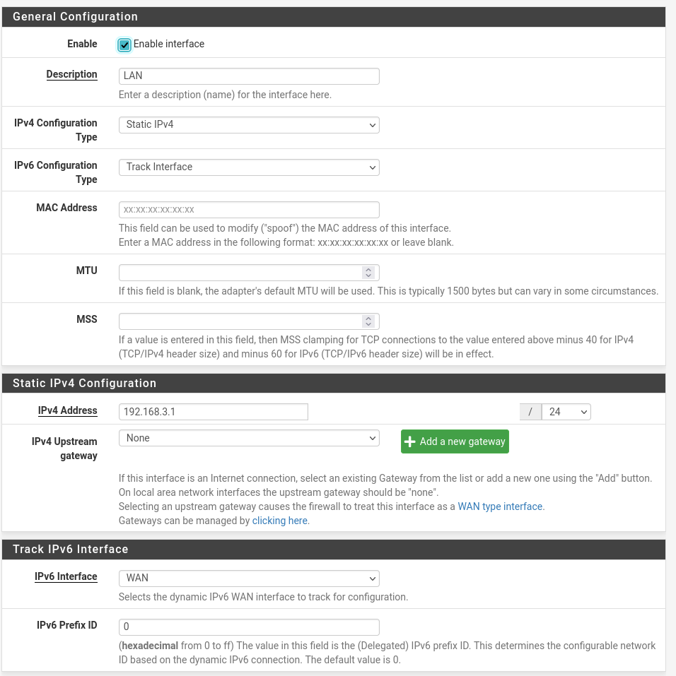

@bob-dig A couple of (edited) screenshots:
@cpf I have no experience with bridges, but with track interface it is always a /64. So I think there is something broken in your config/machine.
@bob-dig When I tried with a regular link (So one of the 4 OPTS alone), it behaved similarly or didn't work at all.
No matter what I fiddle with, the same ipv6 come back all the time.
With 2.7.0 it at least manages an ipv6 for LAN.
It also worked at some point (Screenshot I took back then here)

@nogbadthebad Doing that, a couple of things changed (I just reassigned the same ip static on the LAN network)
First, the interface for the dhcpv6 server changed, it now mentions the subnet in the available range, whereas it previously mentioned "available range :: to ::ffff:ffff:ffff:ffff" it now mentions "available range subnet:: to subnet::ffff:ffff:ffff:ffff"
However, the dhcpv6 server still complains about the specified range being outside the current subnet, which is interesting, since now the subnets should match./edit
