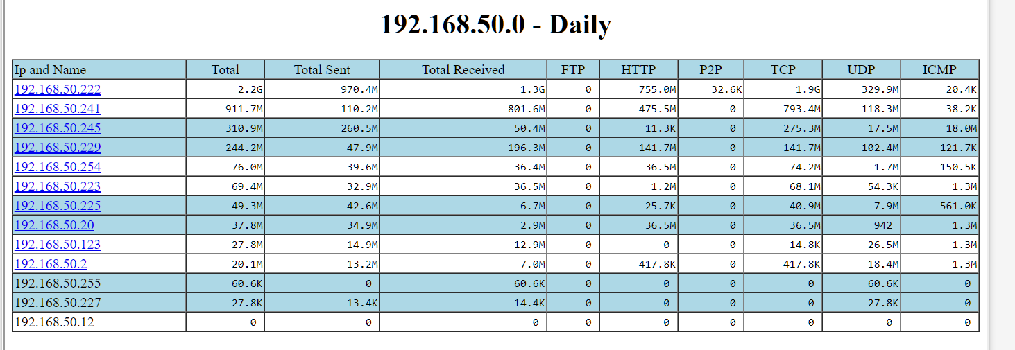

Having issues with the lack of data being reported by bandwidthD. Some of my subnets are reporting data while others are not. These subnets have heavy consumers so there is data.
For example the 192.168.50 subnet does report.

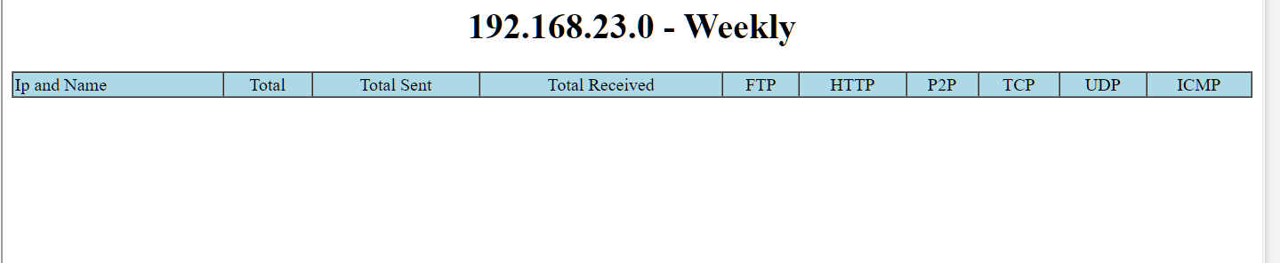

192.168.23.0 has no data even though there are streaming devices along with gaming tablets on this vlan. For the week there is nothing.
The 192.168.23 seems to be the only subnet so far with no data while my other VLANs and my Wireguard interface is reporting.

Its just a trunk interface down to a L2 switch. Nothing unusual.
Whats even weirder is that some vlans on that trunk are reporting data while the one mentioned above is not. -
There must be something different about it.
If you run a pcap manually on it I assume you see data?
@stephenw10 Yep just did and i see traffic there. Specifically, I see the vlan.id tag for the vlan that's not reporting. Ntop sees all traffic on all vlans so this problem is specific to bandwidth.
