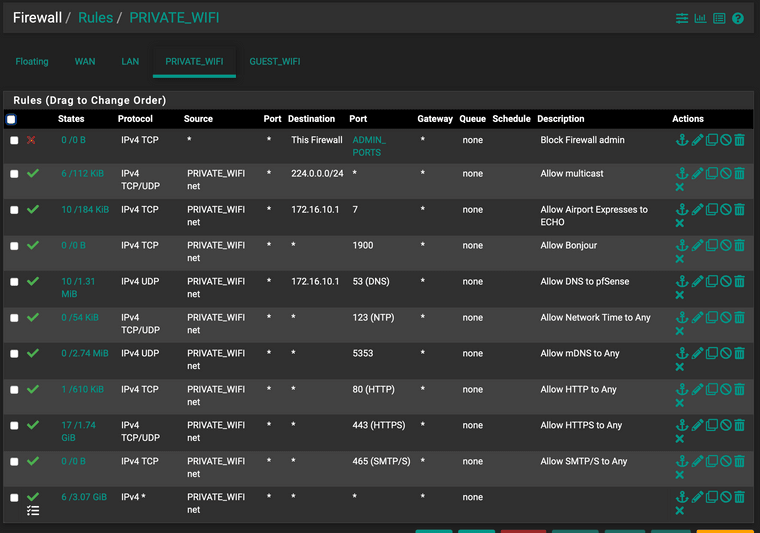

 I'm a new pfSense user with a 2100 for home use and am in the process of evaluating logs to create Pass rules to reduce some of the noise in the logs. After a week or two when I get a sense of what's normal traffic I'll consolidate the rules. In PRIVATE_WIFI VLAN for iPhones, iPads, AppleTV, etc., I see multicast log entries to 224.0.0.2, .22 and .251 without any port number. I created a Pass rule for any 224.0.0.0/24 but I still see them in the log. Similar behavior with 239.255.255.255:1900. Is this a side effect of Avahi being installed? How can I pass and not log these?

 If they are blocked by the default rule, then they show up and then your rule is not 100%.EDIT: Ok, they are allowed by the bottom rule to allow all, because that has logging enabled. Your rule to capture multicasts is not 100% as it is not capturing them (or at least not all).
 It's not always easy with avahi, but usually I would say to create mdns rule as follows:IPv4 UDP Source: * Port: * Destination: 224.0.0.251 Port:5353 So try to test with different rule settings and let us know.
 @terryzb you might want to turn on rule descriptions in the log settings, so you can see which rule is logging those. But yes if you want to allow for avahi to work, you need to allow the multicast address, but that should only really be 224.0.0.251 224.0.0.22 is IGMP and no it wouldn't have a port with it.. its a different protocol - but I see your logging your last rule that is any any rule which yes would log such traffic. See that little menu looking icon right under the green checkmark allow icon.

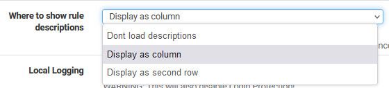

 Thanks John. Yes, I set the any any rule to log so I could see what's still coming into the interface after explicitly passing traffic I'm good with. The rules above are set to not log in order to visually reduce noise in the log so I can get a better idea of what's going on. Thanks for the tip on rule descriptions. I will turn that on to get more info.EDIT: I assumed you were talking about the Dashboard logging widget but I don't see an option for rule descriptions there, or in System Logs->Settings. Where is this set? Thanks,
 -Terry
 @terryzb said in Trying to not log 224.0.0.0/24: System Logs->Settings.  I don't think there is a way to see the descriptions in the widget.

 Thanks John. It was already set to display as column.

 Below that rule, but above your last rule, but rule that says 224.0.0/24 and allow it or block it log it or don't log it, etc.We're completely on the same page about rule order and logging John. My original question was why, even though I had a TCP/UDP 224.0.0.0/24 pass rule without logging near the top, was it still being caught by the Allow any any rule at the bottom and showing up in the log. After your comment about 224.0.0.22 being IGMP, I changed the 224.0.0.0/24 pass no log rule to be IGMP and so far, 224.0.0.2, .22 and .251 seem to be caught by it and are not showing up in the log. Thanks again for your help.
