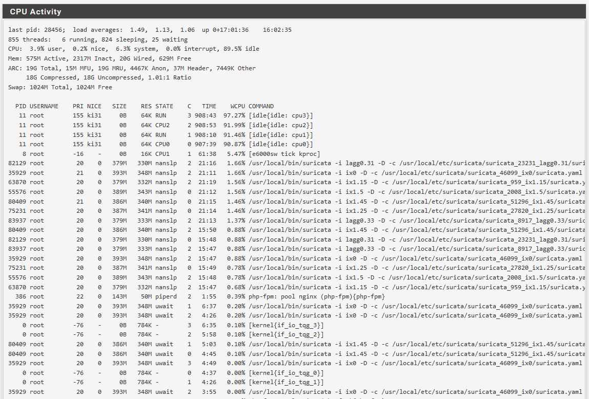

      I've been having a drastic increase in memory usage on my XG-7100U under PF+ 22.05. I don't recall noticing this issue before I upgraded from 22.01. My system under the current configuration has always run around 14-18% CPU usage and about 20% memory usage, and I have 24G of ram installed.
      I noticed very high usage last night and tried shutting down services to see if it would clear, but it would not. After a reboot the stats were back at normal, but when I checked again this morning it was back up to 88% memory usage. Under the system activity screen, all of the ram usage appears to be in the wired memory with 20G usage.
      Here is a snapshot of the top section:

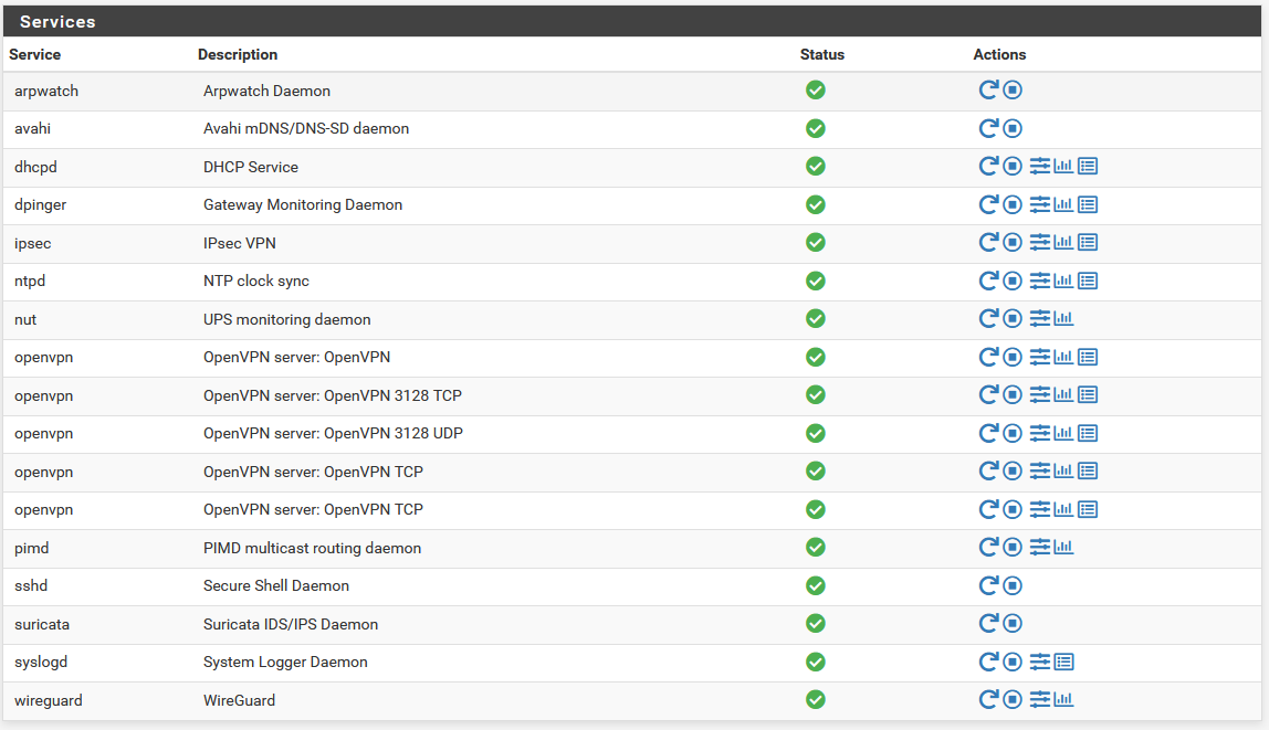

      I tried looking, but only found a general reference to possible a kernel leak, but I couldn't find really any more information and that looked to be under 22.01, which I don't remember noticing this problem. SWAP is set to 1024MB with 0% usage, so it at least isn't causing any paging. Here are the services I'm running:
      Any ideas on where I can troubleshoot to narrow down the culprit, or what I might do next? I don't want to have to reboot my router twice a day to clear out leaked memory. Also hoping I don't have to downgrade to 22.01.

                Hmm, I assume you have tried running with Suricata disabled since that's by far the largest consumer of RAM?
                  sgnoc
                  That was some of the testing I did last night when I first discovered the issue. I disabled the suricata service, but the memory stayed the same percentage. I monitor several interfaces with suricata, but it has only been using about 9.8% of memory. That is definitely one of the largest consumers, but not the 20G of used wired space I'm seeing in the system activity screen.
                  I'm only showing around 604M active and 2319M inactive, which is what I would expect. It appears all of the missing memory is in the Wired allocation. I'm not familiar with Wired memory, though.

                        Something is wrong with your Suricata configuration on that box. Look at how many duplicate Suricata processes you have running. Not saying that is the only cause of your memory issue, but it certainly is one of them. For example, I see four duplicate Suricata processes for VLAN 45. And I see two each for VLAN 14 and VLAN 25. You should have only a single Suricata instance running per interface (or VLAN).

                            @bmeeks I noticed that too, but when I looked into it further, the duplicate entries for each VLAN are running under the same process (same PID), but listed with different states (nanslp, uwait, etc). When I check the process list (ps aux), there is only a single suricata process for each interface configured for monitoring. So, I can't explain why it lists like that on the activity screen, but it looks to be ok overall. Each instance is using around 360M, which I'm fine with since I have 24G total.
                              Doh! My bad, that would be the separate threads assigned to a particular interface. So there appear to be 4 threads running on the VLAN 45 interface. That's fine.
