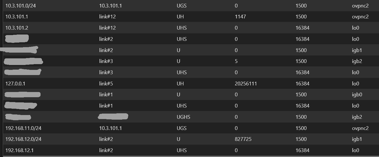

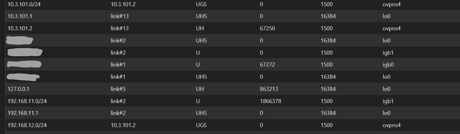

                  192.168.11.0/24 is the LAN network for the machines on the service side of the VPN. Here is a screen shot of it from IPv4 Routes in Diagnositics / Routes:
                  Screenshot 2022-07-18 at 21-46-41 pfSense.biooyaNET - Diagnostics Routes.png
                  Theres nothing else listed related to the LAN network or VPN tunnel, not any item related to the client/remote LAN (192.168.12.0/24)

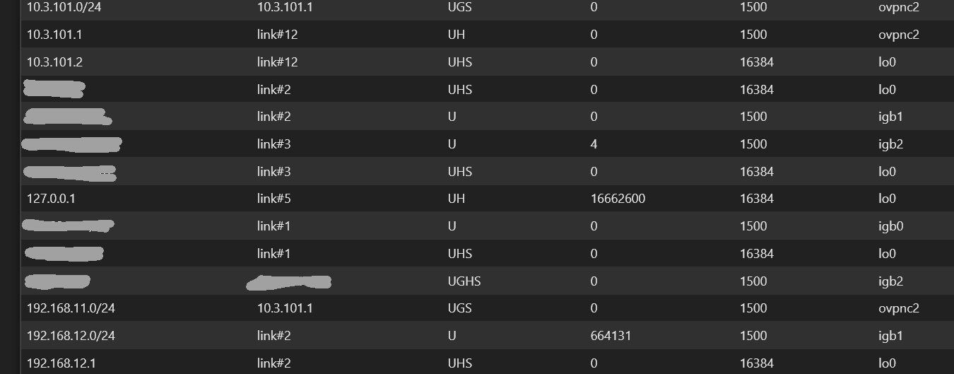

                  Client / Remote Network screenshot of IPv4 Routes in Diagnostics / Routers

                    So you should see a route for 192.168.12.0/24 pointing to the client, when the connection is established. If not, the CSO presumably is not applied.

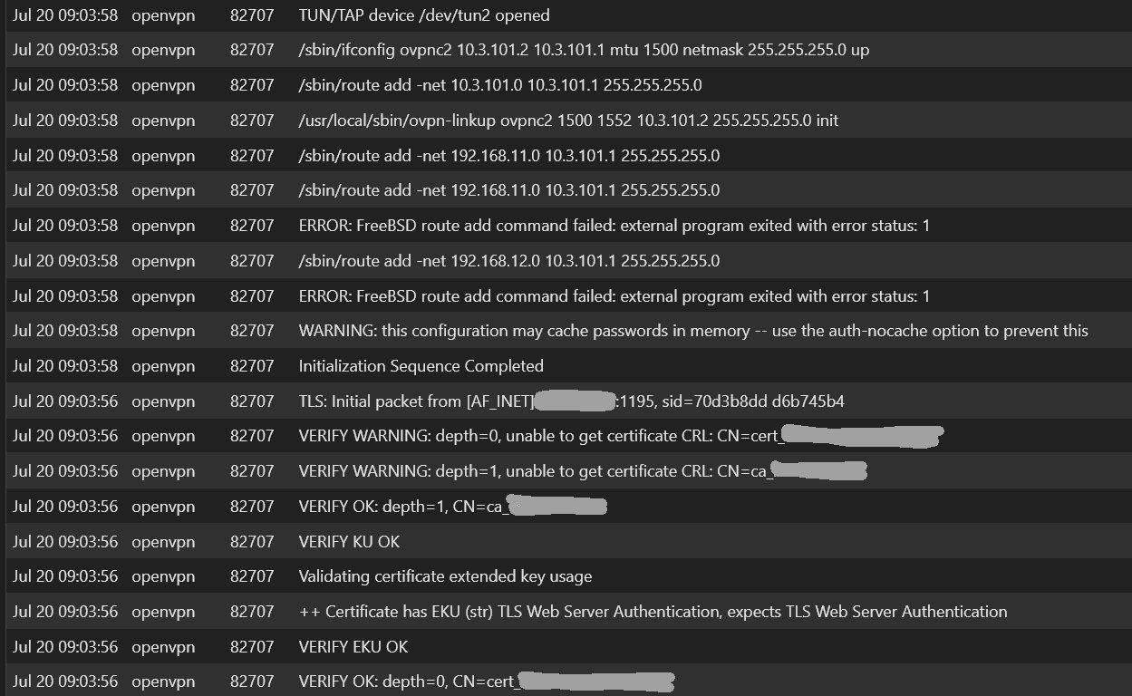

                      I restarted the client connection, and now see a route on the Server to the client LAN (192.168.12.0/24), but connection is still failing (still unable to load resources on client side from server side. For example, from a machine (192.168.11.11) on the server LAN (192.168.11.0/24), I'm unable to access the web admin page of the client router 192.168.12.1)
                      In the OpenVPN logs on the Client, I see:
                      openvpn 	52317 	ERROR: FreeBSD route add command failed: external program exited with error status: 1
                      Routes for server
                      Routes for client
                      • V Offline
                        Some more information on this in the log?
                        Since the client has added the route, it should work from the point of the client. But possibly there is something else wrong in the settings.

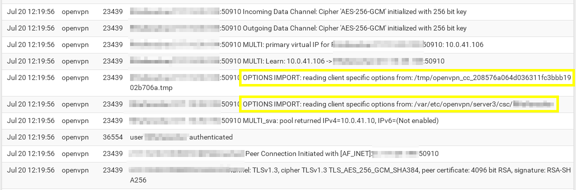

                              Okay, even noticed that the CSO part is not logged with default log level.
                              So I changed the log level in the server setting to 3, then I got the info:
                              X 1 Reply Last reply Reply Quote 0

                                  The server log is way more of interesting here. The CSO part can only be found in the server log.
                                  Error: FreeBSD rout add command failed
                                  This is due the server is pushing a route for the clients LAN network, which cannot be added naturally.
                                  That's why I don't like this setup method as mentioned above. I'd rather add the remote networks in the client config.
                                  However, it should work anyway.

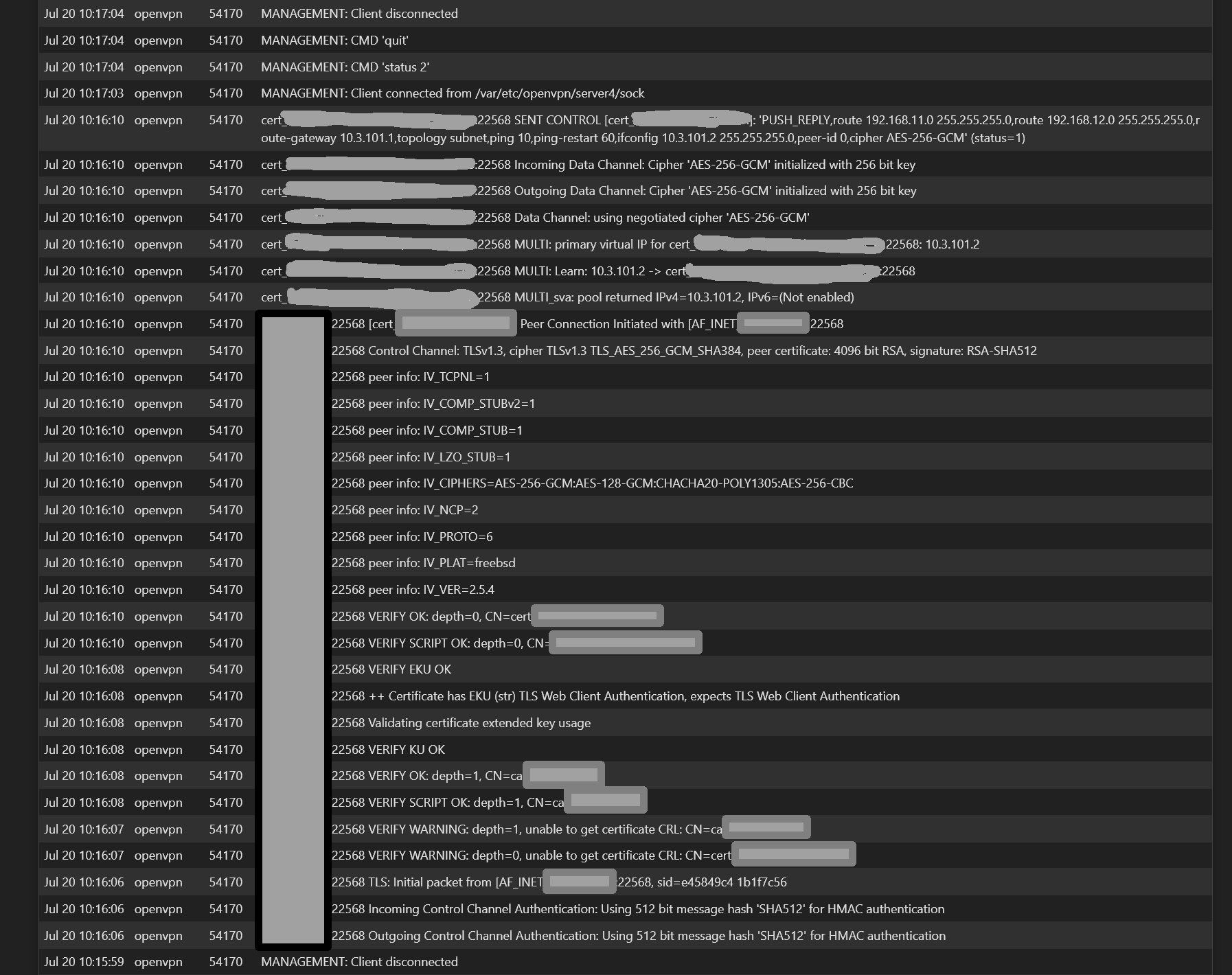

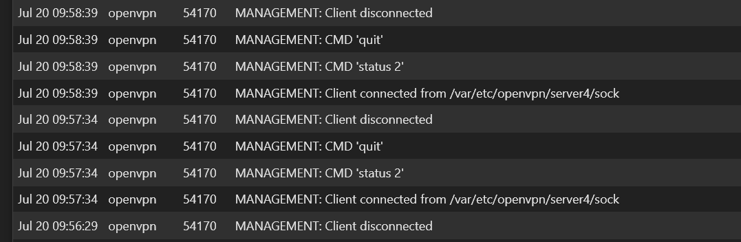

                                    One the Server side verbosity 3, I'm now see this:
                                    • V Offline
                                      viragomann @Ximulate
                                      @ximulate
                                      Need to see the section, when the client establishes the connection.

                                        Server side logs (after reboot of client router)...
                                        server_logs.j (pg
                                        At
                                        Jul 20 10:17:04, MANAGEMENT: .......
                                        Those management messages repeat as shown in previous post
                                        • V Offline
                                          @ximulate
                                          So there is no note of the CSO in the log. Hence the route within OpenVPN won't work.
                                          As mentioned above in post #8 check if the common name in the CSO and server settings are correct.

                                            Ximulate @viragomann
                                            @viragomann
                                            That was it! Its now working. Thank you for your help and patience
