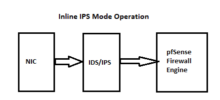

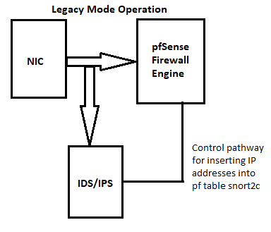

        Are you running Suricata using Legacy Blocking Mode or Inline IPS Mode?
        There is seldom a good reason to run Suricata on the WAN. Suricata lives out in front of the firewall and thus will analyze traffic that the firewall is most likely to be dropping anyway. So why waste CPU cycles analyzing and alerting on traffic the default rule on the WAN is going to drop anyway?
        Here are a couple of diagrams that show the traffic flow with Suricata or Snort enabled in each of the available blocking modes:
        Put an IDS/IPS instance on the LAN and WLAN interfaces only. That will save RAM and CPU cycles and won't reduce security. Suricata is not there to protect your firewall. It is there to protect internal hosts, so put it on the interface that directly connects to the internal hosts (LAN and WLAN). The only way traffic from the WAN can get to an internal host is through either the LAN or WLAN interfaces, so putting an IDS/IPS instance on those interfaces is all you need.
        If you run Suricata with Inline IPS Mode, be aware that uses the netmap kernel device and that device will physically cycle the network interface down and back up each time Suricata is restarted. That cycling can confuse dpinger and make it trigger the gateway alarm I see in your log snippet. That will cause a number of things to get restarted. Suricata will be restarted following any rules update cron job unless you go to the GLOBAL SETTINGS tab and enable "Live Rule Swap".

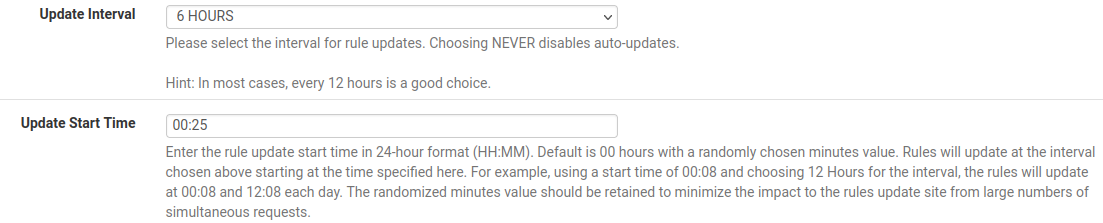

                      What time is your rules update job set to execute? You can find that on the GLOBAL SETTINGS tab. You will also see the times printed in the Rules Update log that is recorded and viewable on the UPDATES tab. The times you have listed in your log snippets don't all match up with a regularly recurring cron task. My suspicion is you have something else potentially going on causing the connectivity issue and your reboot cron task might also be a little too sensitive. Pinging a DNS server may result in dropped replies if the server gets busy. That's because ICMP is going to be considered much lower priority traffic and will be ignored if the circuit or server gets busy.
                      • N Offline
                        newUser2pfSense @bmeeks
                        @bmeeks I have had the Live Rule Swap on Update enabled ever since I've been using Suricata which has been several years. This has been occurring for all of that time, but of course I had Suricata set on the WAN during all this time as well. It was also enabled at the time I created this post, even before you mentioned to enable it when I had Suricata enabled on the WAN.
                        Here is the update interval:
                        Below is a snippet of the rules update log. You can see where it states "Updating rules configuration for...", but it also states "Live-Reload of updated rules requested for..."

                          Your reboot times from the posted log snippet do not line up as I would expect with the daily rules update jobs (every 6 hours). If Suricata was the root cause here I would expect the reboot times to be pretty much identical within 30 seconds or so. There is a random 30 seconds added to the rules update time to help balance the load on the update servers by not having all the configured Suricata installs out there on pfSense all hammer the server at the same time.
                          Notice in your original post your log shows the gateway alarm and other failures occurring at 04:55 or so, and then the reboot being commanded at 04:56.22. That is quite a long time from 4:25 when your Suricata rules job ran. Rules update jobs typically take only about a minute or two to complete. There is about 30 minutes of normal operation between those two events.
                          Now perhaps you have some Suricata rule triggering that is resulting in blocked pings. Have you investigated that avenue?

                                  Those Suricata Stream Events rules such as those beginning with SURICATA STREAM can be somewhat prolific. I would NOT set any of those rules to DROP. If you want to see that traffic, leave them at alert. But honestly, a lot of users don't use those at all as they tend to be somewhat noisy.

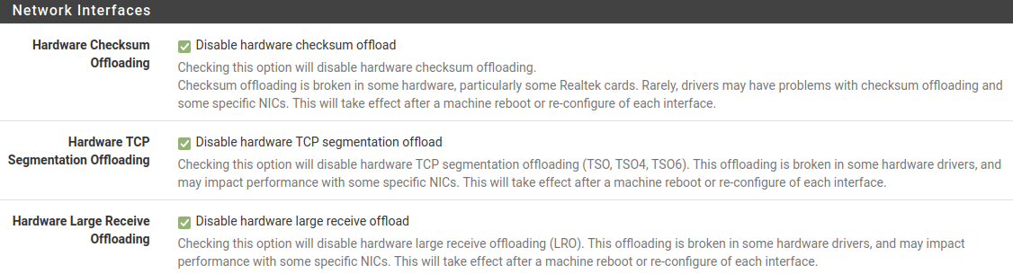

                                          Do you have all of the hardware offloading disabled for the NICs?
                                          The only connection to Suricata I can see would be the use of netmap for Inline IPS operation. You could try swapping over to Legacy Blocking Mode for a test and enable the option for "Block DROPS Only". That would use your existing SID MGMT configuration just without netmap and Inline IPS Mode. If things are stable there, then you have your answer -- it would be a netmap compatibility issue with your NIC.

                                            Here is the offloading:
