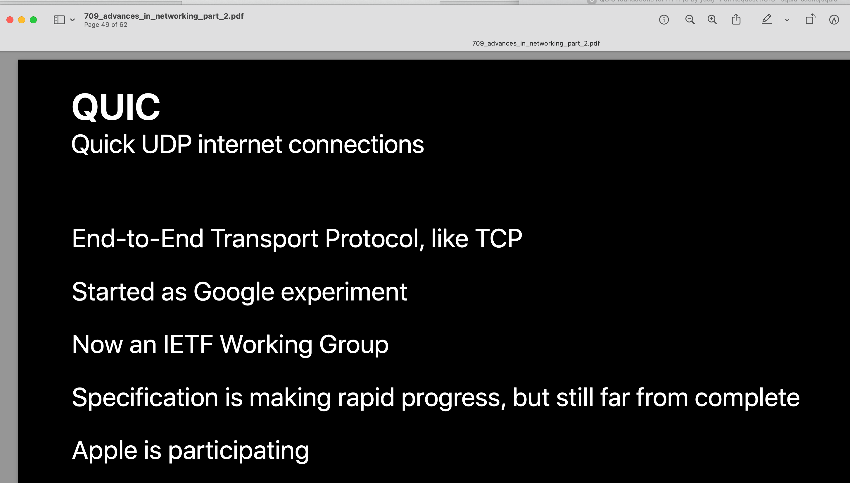

                      @stephenw10 I can the pcap on pfsense.
                      HTTP/3 is no longer experimental and is fully active in the iMac it can no longer be disabled manually
                      2017--> was still in development
                      2021--> This was the background and code for how it works with applications
                      https://developer.apple.com/videos/play/wwdc2021/10094/?time=16
                      2024--> Apple has fully activated this on the Sonoma 14.5 and Safari 17.5 it has no option to disable like the link above has.
                      It also has HTTP/3 DNS much like DoH however pure UDP let's call it DoH/3
                      DoH/3 seen here:
                      Make sure to upvote
