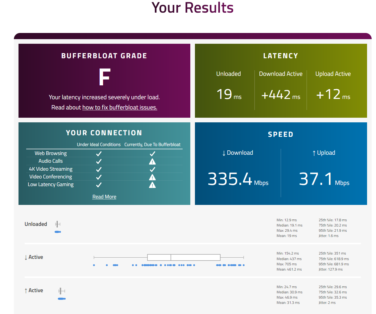

                        yes all ping tests I do are with dslreports.com/speedtest running
                        on dslreports bufferbloat is a D
                        on https://www.waveform.com/tools/bufferbloat:

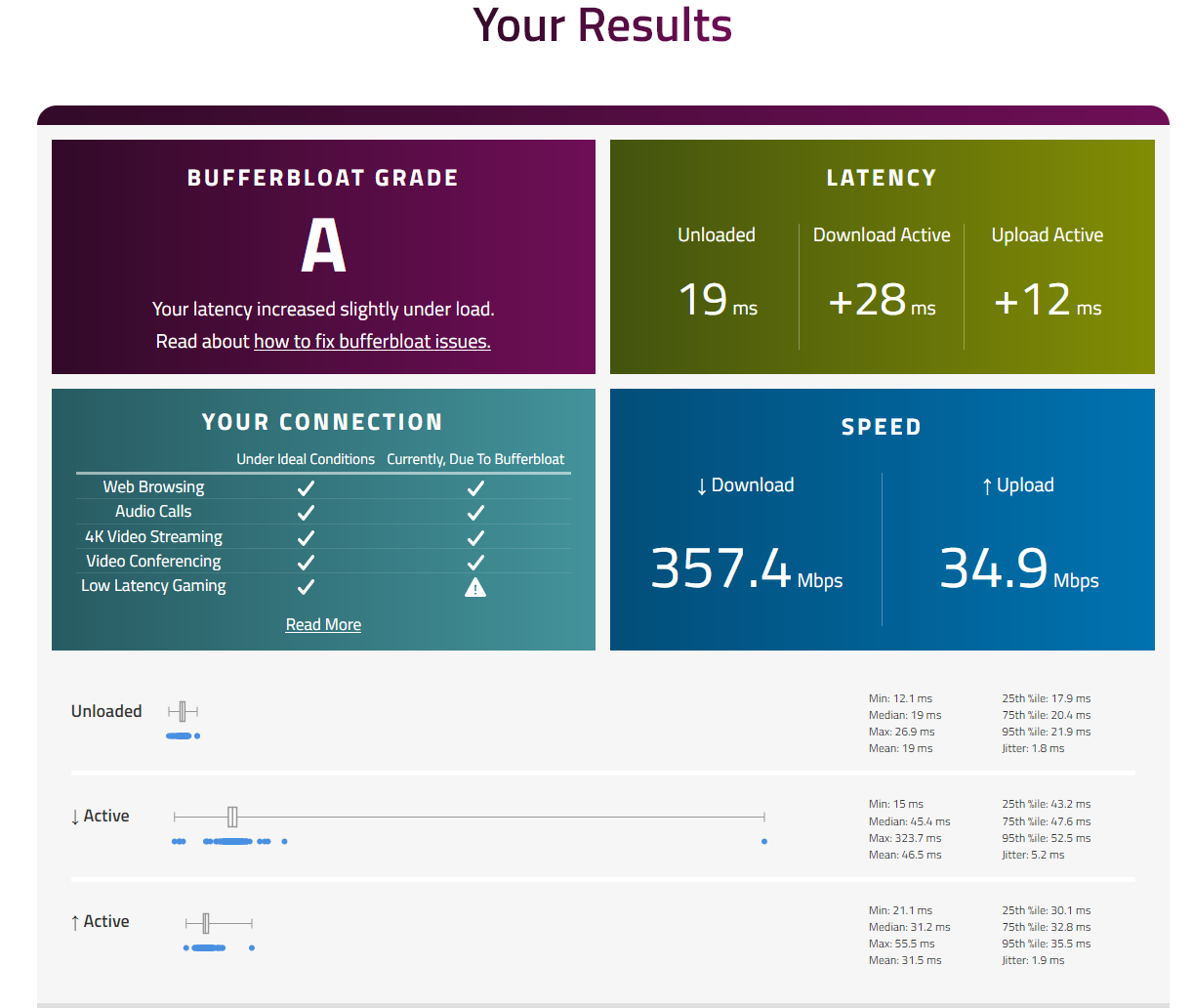

                        3th bufferbloat test:

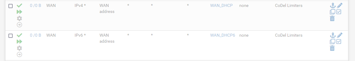

                          Wen i setup the codel limiters like it is explained in the docs.
                          and then test it with a speedtest the wan stopts working all together i can't reach anything anymore on the Internet.

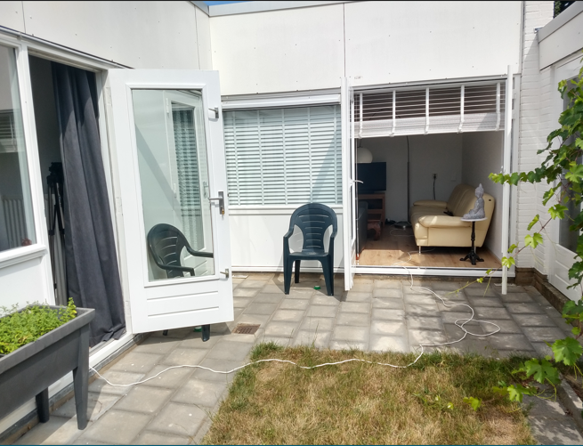

                                  tested all cables temperarly replaced them
                                  I connected a 20 meter cable from modem to the pfSense wan. No change.
