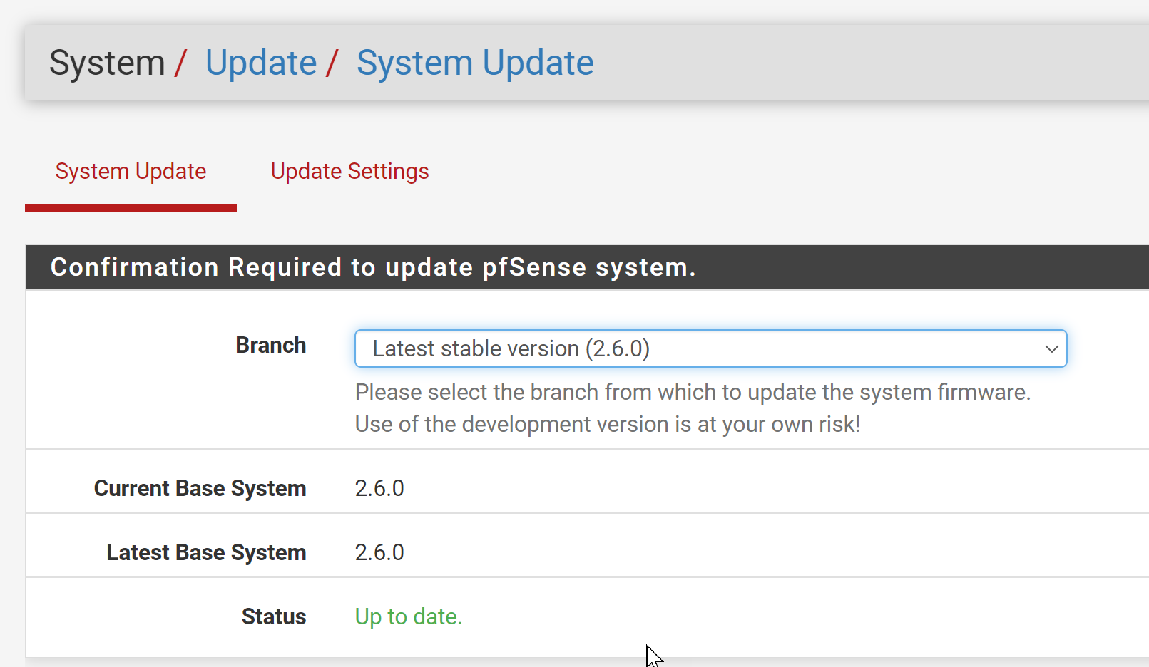

              swinster @swinster
              This is how things are currently:
                Hmm, how did you downgrade? That's not something you can normally do. Especially between 2.7 and 2.6 because of the FreeBSD base change.
