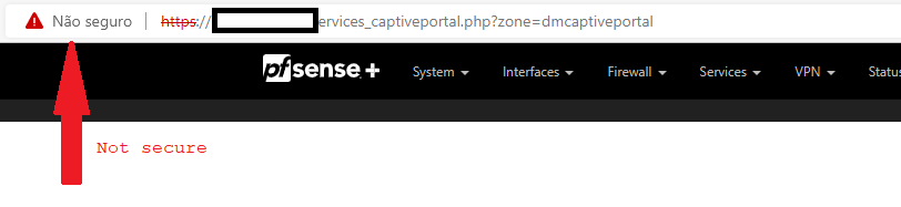

      Hello, Firends.
      When I open pfSense GUI I see the warnning for not secure URL.
      How to configure pfSense in a way that browsers can "understand" the pfSense URL as secure?

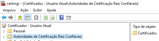

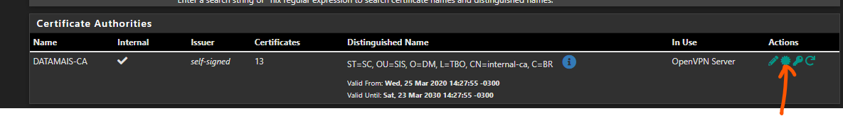

            hugoeyng @Jarhead
            @jarhead Thank you for your answer.
            Export from here:
            to here:
            Autoridades de Certifcação Raiz Confiáveis = trusted root certificate authority
            Don´t worked.

              johnpoz LAYER 8 Global Moderator @hugoeyng
              @hugoeyng well that is not the CA that signed off on your gui cert.. That is a CA for openvpn you must of created when you ran through the wizard for openvpn.
              Create a cert with a CA you created, and trust.. Set your gui to use that cert and your browser will not balk at it..

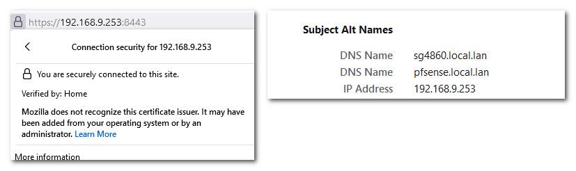

                      johnpoz LAYER 8 Global Moderator @SteveITS
                      @steveits said in "Non secure" pfSense URL:
                      hostname then an IP will never match the certificate
                      Not actually true ;) if you have put in the IP in the SAN it can validate just fine.
                      Nice thing with creating your own CA and signing your own certs with them, you can use whatever fqdn you want, and you can use rfc1918 IPs as SAN as well, etc. And if you had created them before the browsers got a stickily about age of the certs, you could have made them valid for pretty much how ever you wanted to make them.. Mine are good for 10 years.
                      I still want to play with if I set time to before browsers put in that limit on age when create the cert and see if works ;) I will prob play with that when I finally get around to changing to home.arpa domain.
