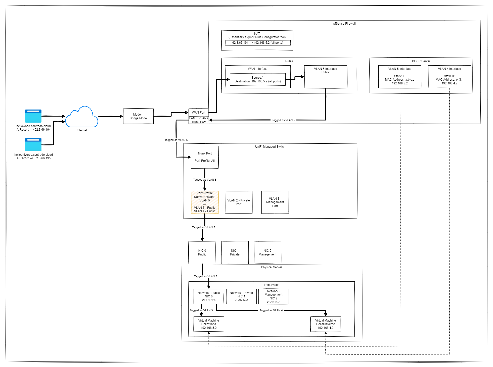

          @rcoleman-netgate This is the setup at present;

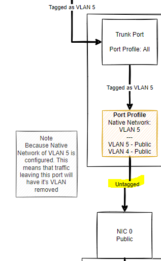

          What is behaving weirdly which I'm struggling to get my head around is the orange box highlighted on the diagram. When that has a Native Network of VLAN 5 (plus the VLAN 4), this works. But if I remove the Native Network and just have VLANs 4 and 5, it doesn't work.
          I'm thinking I've got something not quite configured correctly at the bits beneath this.
          At present, the two websites are both configured within the same VLAN 5. What I want to test next is to split them out each onto their own VLAN for added security.
          I even just tried creating a new vNIC on the Hypervisor and configured that as VLAN 5, attached that to the VM. Updated the static IP mapping in pfSense to use the new MAC address, but that didn't work, the website didn't load. Perhaps I needed to configure something at the Linux level and didn't.
          Feels like I'm just missing a piece or two of the puzzle that isn't quite lining up correctly in my brain. Hopefully the diagram helps to set the scene and hopefully identify the thing that is obviously wrong in that diagram that I'm just not seeing.
            If you need to set the PVID on that port to 5 to be able to get two way traffic then the traffic is arriving on it from the hypervisor untagged when it shouldn't be.
            It might also be leaving untagged from the switch if you set that. I'm unsure what takes priority in a Unifi switch. It can't be tagged and untagged on VLAN5.
            That would make more sense though because trying to arrange the hypervisor interface to be tagged on way only is probably difficult!
            So I'd guess the physical NIC on the hypervisor is not using VLAN5 as it should be.

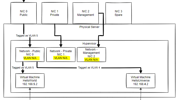

              Terminology: PVID = Port VLAN ID
              So at present there are 4x physical cables going from the UniFi Managed Switch to the physical server with the hypervisor installed.

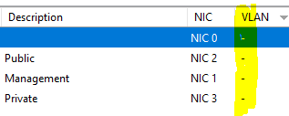

              So I have created 4x networks initially on the hypervisor, just so that I could figure figure out which physical NIC mapped to which physical cable and hence which VLAN it should be using;
              As you'll see in the above though, those networks do not have a VLAN configured. This is the snippet from the hypervisor (the numbers don't line up to the diagram, but you get the idea)
              My understanding around networking across the different physical and virtual layers is that 'things' should be tagged at every step along the journey.
              I'm going to try this next;
              1. Create a Hypervisor network - Public VLAN 5, tagged as VLAN = 5, on NIC 0 (diagram, not screenshot)
              2. Spin up a new VM with that new network attached + install OS (easier than messing around with Linux networking)
              Feels like this is a step in the right direction.
                Yes this is almost certainly because the hypervisor is not actually using VLAN5 for the interface linked to that VM so you actually need to untag it at the switch to make the connection. Which is what you were unintentionally doing by setting VLAN 5 as the 'native VLAN' for that port.
                So, yes, set the hypervisor interface to VLAN5 on NIC0 there. Unset VLAN5 as native for the switch port.
