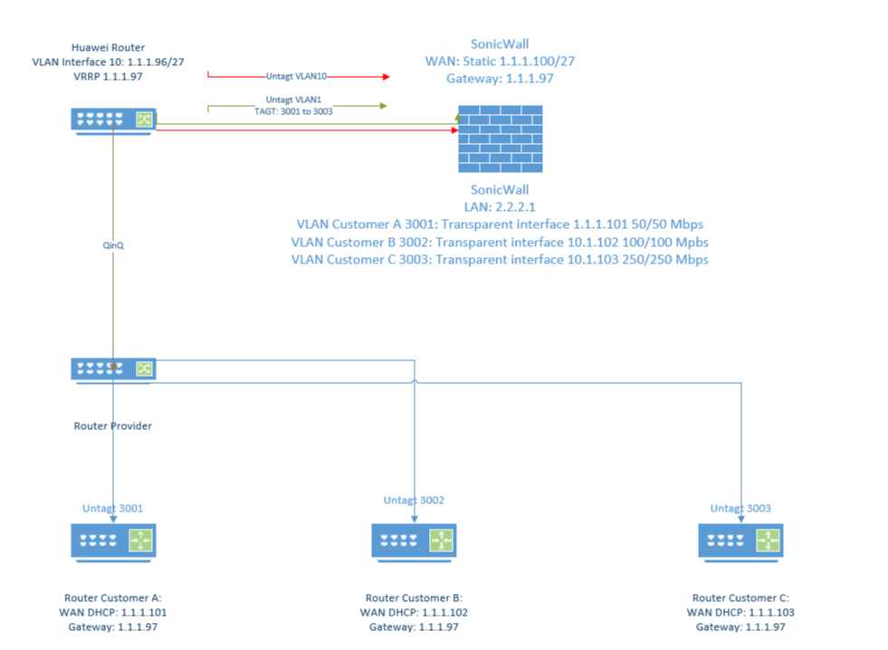

                    rvdk92 @stephenw10
                    Thank you for your answer.
                    To be clear, I've uploaded a picture of the situation now.
                    1 Reply Last reply
                    Reply Quote 0
                    • stephenw10S
                      Ok you have VLAN Customers B and C shown as 10.1.102 and 10.1.103 at the Sonicwall there. Is that just a typo?
                      But all the devices are using the upstream router as the gateway there which removes the asymmetric routing issue. But is also contradicts what you wrote earlier, or at least as I read it.
                      R 1 Reply Last reply
                      Reply Quote 0
                      • R
                        rvdk92 @stephenw10
                        Sorry yes is typo! to quick!
                        But is this also possible with pfsense.. so if i can replace the SonicWall for a pfSense firewall?
                        1 Reply Last reply
                        Reply Quote 0
                        • stephenw10S
                          Possibly. 😉
                          It's not something I would normally advise doing. The traffic shaping could be problematic. The filtering to keep each customer separate will be...interesting.
                          But it might work I can only really suggest you try it if you can test it in something.
