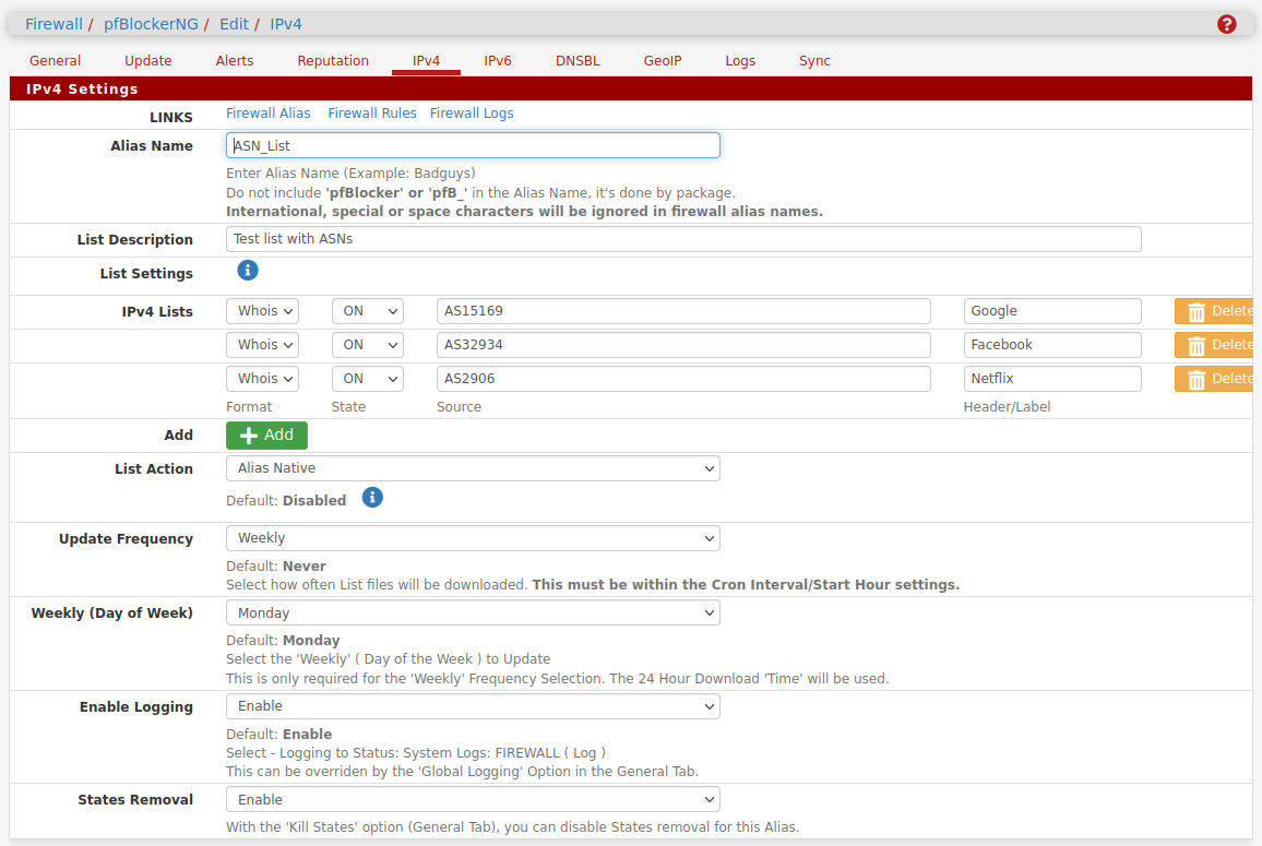

                                  Set your list action as 'alias native' rather than block or reject. Then use that alias in your VPN bypass rule.
                                  You probably want to use ASNumbers. You might need several dependiong on what you;re passing:

                                          I know this is a dumb question because I feel stupid right now but, where do I find those "ASN numbers" for pfblocker to make that list?
                                          Thank you Sir!
                                          Dale
                                          • K Kilted1 referenced this topic on
                                            Hmm, I think I just googled it. Like: https://asnlookup.com/organization/facebook/
