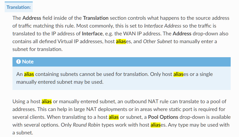

              @viragomann The documentation states to use an Alias
              I should be able to pick any free IP in the range and use it but so far what works is using the Interface IP on the firewall.
                  As mentioned here three times already, the translation address has to be assigned to the pfSense interface, either its's the primary interface address or a virtual IP.
                  You can state an alias though, but this condition has to be matched anyway.
                  Any IP assigned to pfSense interfaces can be selected from the drop-down. That's why I'm wondering that you were stating an alias there.
