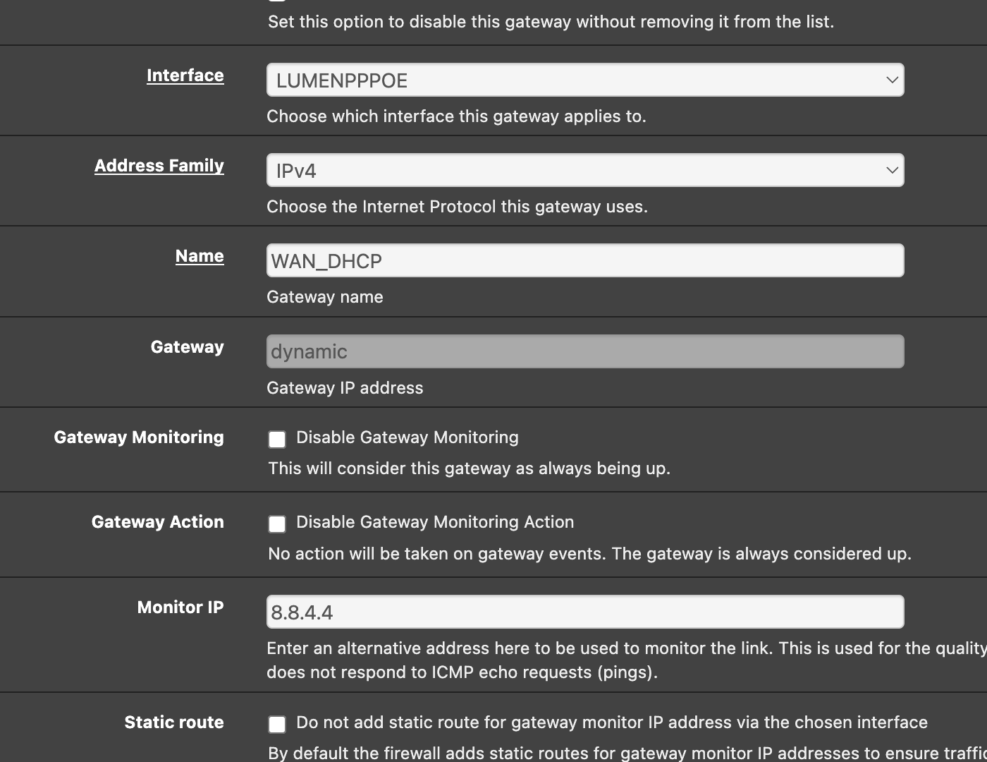

      After I upgraded to 20.05, my WAN_DHCP gateway will not connect to my ISP. I can connect another device, works fine and I can connect my 20.05 devices WAN interface to the other device as if it was the ISP and works fine. Any advice would be appreciated.
        rcoleman-netgate Netgate @bakakuma
        @bakakuma Change your monitoring IP on the WAN Gateway to something that isn't blank. Default it uses the next link up the chain but some ISPs block that as a DoS attack.

          bakakuma @rcoleman-netgate
          @rcoleman-netgate I have done that. I used 1.1.1.1 cloudflare and it didn't help.

                • B Offline
                  @rcoleman-netgate i ran the fully recovery and did just a basic config and i get the same results. the gateway shows as down with 100% loss when i use my ISP as the WAN_DHCP and works fine when I use any other DHCP source on the WAN interface. Also my other device works fine with my ISP. I will request an older release to recover to and see if that works.
                    Is it actually pulling a DHCP lease correctly? Showing a valid gateway?
                    If the WAN shows as UP but you cannot connect out on it you may have a bad lease there. A cable modem handing out private IPs for example.
